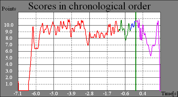

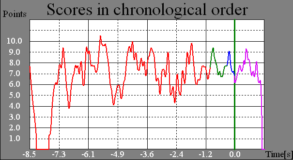

I'm spending lots of time on the Rika and now learning to analyse my 'form'. One thing I have noted is that the longer I hold the more the front sight pin drifts to the right and it take a real concious effort to centre it again. My holds vary from 6 to nearly 20 seconds.
A 'good' Rika Trace of my holds (second image) show periods of good hold then I lose it then I get it back. On many traces, however, it looks like a heart monitor and the first image shows the drifting off.
Any ideas or suggestions? My first thought is the trigger position. I have the right hand edge of the trigger located in the first (top) joint of the trigger finger as this provides me with avery nice feel for repeating the trigger finger position BUT the trigger may be a little too far forward thus trigger finger pressure may be pushing it to the right.

- goodHold.gif (14.33 KiB) Viewed 2403 times
- badhold.gif (14.79 KiB) Viewed 2403 times

Actually the front pin is drifting to the left in the sight picture (compared to the back sight). What a novice - can't even tell my left from my right :)
Have been doing much better the past week. I'm treating the target as basically a second thought. All my concentration is on the sight picture. The 'aim' isn't perfect but the triggering is now coming back to the hold area (and the hold area is somewhat larger). My scores in live fire have also improved. 515 average is now 535 and it's improved my .22 precision and duelling as well.
