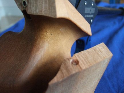

As I have stated repeatedly earlier, the MG2 I have owned for more than 4 years have always ruined all matches I have participated in (with said gun).
I hoped the MG5 would srve me better.
Last weekend I drove some 800 km (500 miles) to participate in an important free pistol competition abroad.

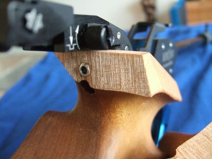

During the match the grip of my MG5E suddenly broke! It broke (not merely fractured, it broke into two separate parts!) at the thinnest part, just above the "web".
The grip felt a bit tight that day, I admit, due to a ambient air temperature of about 22 degrees C. But the grip was not so tight that I could anticipate cracking. No way.
At inspection of the grip by more participants at the competition, the problem was rather adressed to inferior quality of wood.
The grip had not been carved, or altered in any way!
My MG5 is brand new, I had fired some 200 rounds only in this MG5 prior to this competition.
I intend to bring images of the broken grip in the near future.
Tried several times to post an image of the broken grip today, but all attemphs failed.
Image file size (jpeg) var a mere 600 kilobytes. Error message from TT read: "The file size limit of 33 Megabytes was exceeded". (Rubbish...).

MG-5 Owner's broken grip images. Posted with his permission.

That is a real shame---I am heartily sorry for this terrible inconvenience to you. Of all things to go wrong, the grips certainly are the last to ever come into your mind---correct???? I don't know what it is with Match Guns products but they seem to have a black cloud over them. I see you also suffered with the MG2---I will not continue on this note as there certain forum members who have rather thin skins when it come to that product. I have had the estimable opportunity to shoot the MG5 and was very impressed with the balance and the trigger performance. I personally try to shoot a TOZ as my personal choice (Match Guns is a turn-off to me due to my MG2 experience). I hope you can get a new grip or at least do a good repair on this one---I would suggest doweling the grip and re-gluing with a good waterproof carpenter's ( yellow) glue. Looking at the pix of the break (clean) I would use a "dowel center" on the right side and drill 1/4" holes in both pieces, and a piece of suitable length 1/4" dowel and the glue I suggested. That repair will never break at that spot again---quite obviously something was putting pressure on that section and the wood separated. "Doc"

Yes. the break is clean, and the orientation of the wood fibres is clearly visible too. I think that is the cause of this mishap.
I will not blame MG for this failure yet, as the grip may be a subcontractor product (?)
I have been in tuch with the importer, and I hope his efforts relative to the MG company will solve the matter.
I hope my (otherwice) lovely MG5 will be brought back in proper shooting shape in the near future. Or so I hope...
If (any) progress in this matter is of interest, I'll keep you informed.

- it is pretty easy to repair with high strength wood glue.
- I am afraid that it will break again since that piece is thin and the wood fibers are in the wrong/weak direction. A laminated grip with crossed wood fibers will avoid this. May be you could try to get a refund for the grip and buy a laminated Rink grip. I have one on my Hammerli 160 and it is excellent with nice adjustment possibilities

A friend of mine repaired a similar break on another manufacturer's grip using dowels and, I think, Acraglas. He claimed the repair was stronger than the original wood. It never broke again.

In case of the FAS, the reason's probably that they used strawberry - wood for their laminated grips instead of something durable - striving to help the boss' Rolex collection. All other grip breaks I've seen so far (not all that many factory grips - it's something else of course, when the grinder has come near them :-) happened because the grip got pressure from the frame or some screw - even grips have tolerances, and sometimes they warp. And shooters tend to tighten everything to the max, except their underarm muscles :-D

1) If You hesitate about reliability - use wooden injections (plugs) with glue.
2) If You think, that grip strong enough - use wooden plugs anyway.
Amen.
