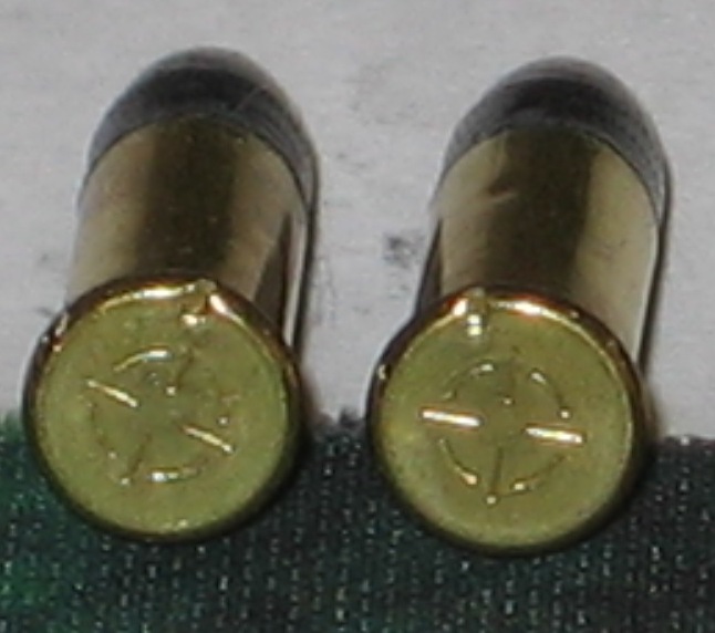

I have a new-to-me FAS 607 which misfires about 10% of the time with all types of ammo. The case rim indentations show a strong hit, but a definite bias to the outside of the rim where I doubt there is much priming compound.

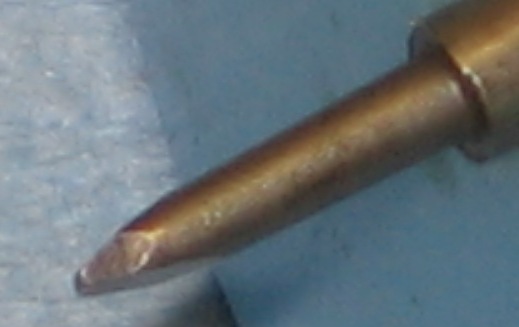

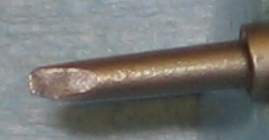

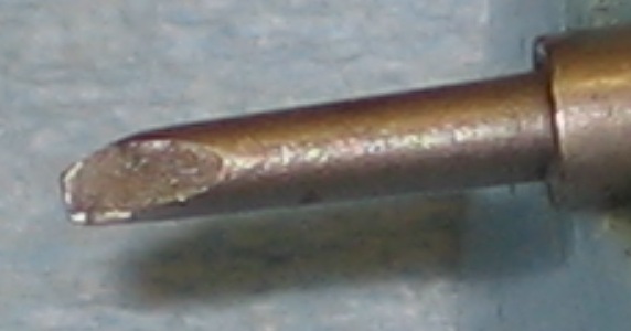

When I removed the firing pin to check it, I found that a portion of the tip had been ground away where it would normally strike near the center or inside of the case. This is the precise area that is not being hit much at all on the rim.
My question to those more familiar with the FAS: Based on the attached photos, is this a normal profile of the firing pin tip, or has someone butchered it with a grinder?
If the firing pin has been altered, this is an easy fix assuming I can find a new one. If this is what it's supposed to look like, however, suggestions to resolve the misfires would be greatly appreciated.

Thats not normal, its been butchered with a grinder.
In fact normally the TOP edge would be ground off to achieve a better strike.
Will post more detail later.

Butchered or broken. I wonder if the previous owner dry-fired it without the hard rubber plug in the breech... (You have one, I hope...)
The end of the pin should look more-or-less like a screwdriver blade: the thinned-down end extending across the whole diameter. The indentation on my SK / Lapua cases (just tried a couple of empties) very nearly reaches the little manufacturer's arc impressions, so about twice as far to the centre as yours. Strength of strike looks fine - they don't seem to hit particularly hard.

It is quite normal, in fact a good idea, to grind off the corner of the firing pin. As James correctly says however, it should be the top corner so that the strike is just inside the edge.
