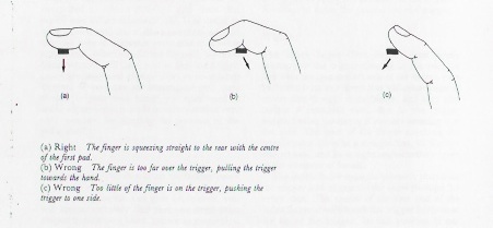

Trigger Finger Position
Have you considered what the best position is for your trigger finger?
See the attached image illustrating that the trigger should be pulled straight back by positioning the trigger against the flat part of the finger in a distal position from the joint. You may struggle to get a straight pull back of the trigger using your finger joint.
Does this make any sense to you?

As per the picture above, the trigger should be on the flat of the finger as in a) - if you move your finger to the optimum place, that should help you and in more than just reaching it. You can always remove the trigger she completely and just use the retaining rod. A little unorthodox but I've seen people do that when they have no other way to reach the trigger properly - and do so very well.

I'm investigating a possibly similar problem with my daughter. She is now shooting my Benelli MP90S, and I got her small Rink grips. With no pressure on the trigger, her finger is positioned as in Figure (a). Most of the time she shoots reasonably well. However, especially when she shoots sustained fire, she tends to shoot to the right. I've watched her closely, and I can't see that she's getting her thumb in the act.
I've been wondering if she is pulling the trigger sideways. It seems to me that for a trigger with significant movement (which is the case with the Benelli), that you would like Figure (a) to apply when the trigger is to the rear, just as the shot breaks. This means that the trigger will be slightly forward at the beginning of the squeeze, a tiny bit like Figure (c).
I'd be curious if anyone has any thoughts on this.

You are correct.Gwhite wrote:I've been wondering if she is pulling the trigger sideways. It seems to me that for a trigger with significant movement (which is the case with the Benelli), that you would like Figure (a) to apply when the trigger is to the rear, just as the shot breaks. This means that the trigger will be slightly forward at the beginning of the squeeze, a tiny bit like Figure (c).
The Benelli's I've seen so far have no adjustment of 1st stage travel. On the other hand, I'd say that the position at the beginning of the movement is not really all that relevant. From my understanding, to get shots to the right via trigger, one would have to have situation b), which is not all that common and usually easily corrected. Not to change the topic, but the Rink grips I know are all hanging to the lower left (at least that is my impression when holding them), and tend to pull to the right when the forearm muscles get seriously engaged during rapid fire or so (something I've seen with several people in my club).
