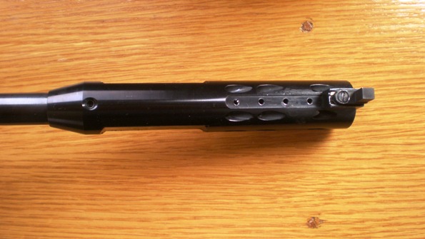

Pardini Rear Sight, with adjustable window.
Simply drop in, with 2 mm screw.
Pardini is higher than original one.

You need longer 2 mm screws! There is two other options. Screw it on a new made sight blade (the holes does not line up on an original, slightly offset) with the original Pardini sight blade screws OR glue it on a original TOZ blade. I did the latter. Works fine.

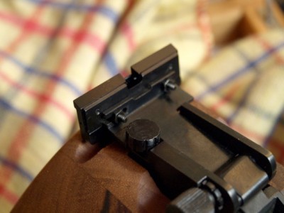

Fix it with longer (10mm used in pics) 2mm screws:

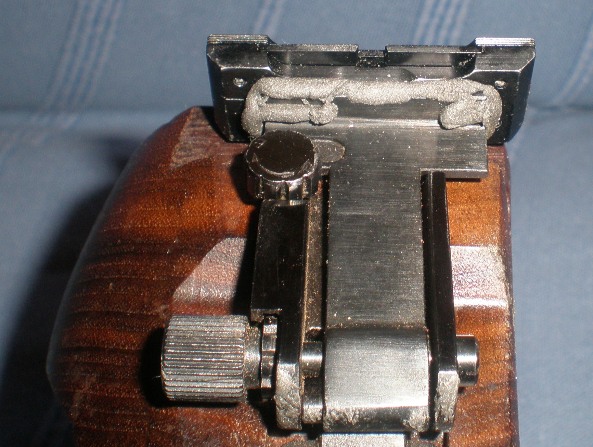

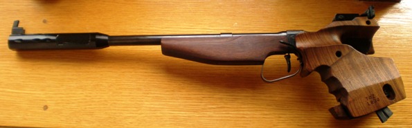

My Toz 35 M
Benelli Kite Rear Sight
Aperture: turning towards (+) increases the width of the sight: turning towards (–) decreases the width of the sight.
Elevation: turning towards (+) reduces sight aperture elevation; turning towards (–) increases sight aperture elevation
I used Steel epoxy putty stick to glue the rear sight.
On the front i use a Morini front sight.
Have raised the front sight with a piece of aluminum with 8 mm in height.
Works perfectly

Bigger adjustment range? What more do you need? The easy Pardini solution does make the rear sight some 20 "clicks" higher though, the depth can be "adjusted" by inserting sheet metal under the Pardini sight when you screw it on if the need should arise. A Morini rear sight is will cost twice as much but if you already have one............... I have seen a Styer rear sight been used too.

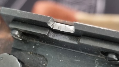

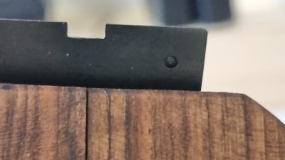

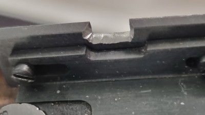

i managed to borrow a pardini rear sight and mounted it on my toz, along with a wider front sight (3.9mm)
the pardini max width is 4.7mm, a tad too small for the new front sight

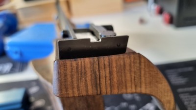

also it;s much taller and thicker-> the rink grip would not allow it to drop low enough. i would have had to carve out some wood for it to drop lower
so..in the end, i followed Rover's advice and got with the file on one of the replacement toz rear sights
i got it to 5mm width and now it;s perfect for the new front sight (sight picture similar to my P8X)
it also saved me ~150 euros to buy a pardini rear sight
