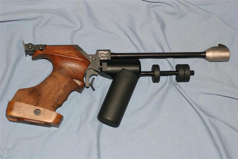

I think you may find the balance on the Walther to be a benefit for a steady hold. With it's angled down cylinder design the center of balance is lowered and the counter weight set-up would also add to your ability to fine tune the balance. Trigger is good, perhaps a bit better than the Model 2 but I do find both of them fine for me.

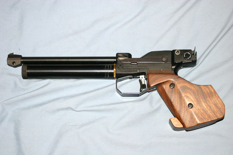

Have owned and shot both extensively. The Steyr is a "Swiss" watch: the Walther is a solid,well thought-out AP :
* CMP-1 weighs some 100 gm less and its C.G. is aft - closer to the trigger than the LP-1, but I'd never consider the LP-1 "nose heavy". This (C.G. - weight differences) gives the impression that the Walther is considerably lighter than the Steyr.
* The sight radius of the CMP-1 is about 30mm less than the LP-1 whose overall length is maybe 40mm longer. You can adjust the radius down a bit on the LP-1 but can't make it any longer on the CMP-1.
*While considering sights; the rear sight width is adjustable on the LP-1 - fixed on the Walther. Different width rear sight inserts were made for the CMP-1 and might be available.
*The simple construction of the Walther makes part replacement, lube etc. quite easy. The Steyr, for routine replacements such as tank and breach o-rings, is simple but things past that get involved.
* Parts for the Steyr are available from our host; Earl's has been great source for Walther parts.
*With the machine rest pellet testing I did, both are capable of one hole groups equal to their factory test targets. Neither is inherently any more accurate than the other.
*The trigger feel/quality can be adjusted to be just about equal but I think the Steyr has a slight edge. Blindfolded - I could not tell the difference.
*Both have "Morini style" grips. Both are adjustable for rake but the Steyr in addition is adjustable for cant.
* Have no doubt that the market price of a LP-1 would be maybe $200 more than the Walther. That money can buy a lot of pellets!
