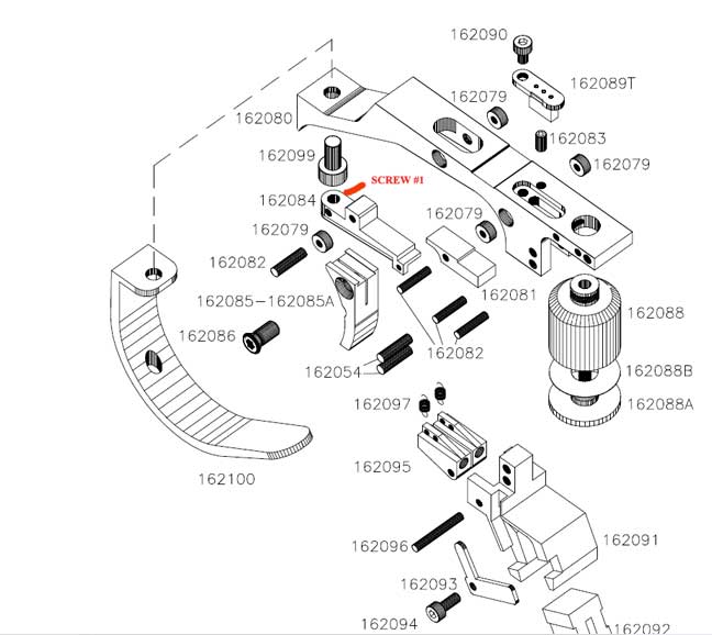

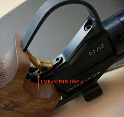

- I mean this screw
- Morini2nd screw.jpg (11.91 KiB) Viewed 3109 times
- image from the manual
- Morini manual.jpg (40.35 KiB) Viewed 3109 times
Screws...
Refering to the picture-
The screw in front of the trigger blade is total trigger travel.
The screw in trigger allows the trigger to move for/aft.
The hole behind the trigger is theaded and is intended for a trigger stop screw (used on the mechanical trigger). NOT fitted on the electronic trigger--not needed.
The trigger weight screws are located in the weight cams. (parts 162095)
One for first stage, one for second stage weight.
The hidden switch screw is part 162083 on top of the trigger frame. This adjusts the setting between bar 162079 and the switch 162089T.
