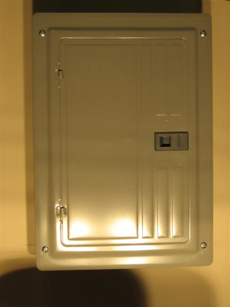

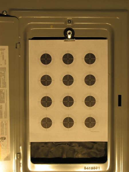

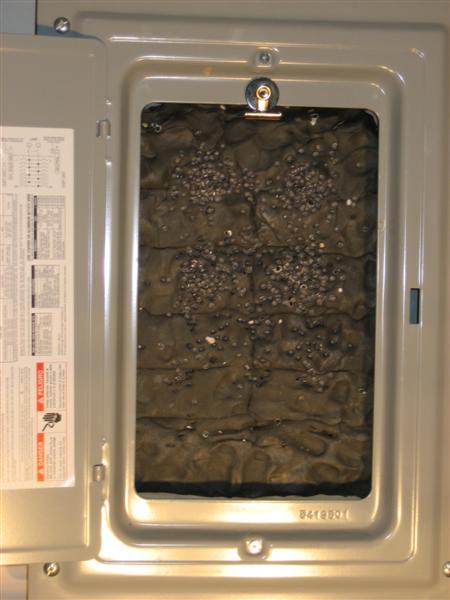

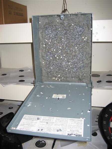

OK. Here you go:
The bottom photo is of the first pellet trap I made. It's a small metal electrical breaker box barely large enough to hold a standard sheet of paper as a target. The door pivots down. This works OK for me, but you can undoubtedly see a number of shots that missed wide; the boys aren't as careful about always hitting the paper. You can see the many thousands and thousands of pellets embedded in the putty, as well as many of the boys' airsoft pellets. This is in our basement 6 meter range.
The other three photos are of my second-generation trap. It's a much larger metal breaker box with sideways hinged door. This holds slightly more duct putty, but has a very large metal area around the target area to catch boy's errant pellets. Funny thing is that since I installed this trap in the garage 10 meter range, they've not missed the paper.
I bought all the materials (boxes and duct seal putty) at the local Home Depot and/or Lowe's. I think the first, smaller, box cost less than $10, but the second was around $25. The putty is about $2.00 per one-pound "brick". It seems like the first trap used about 7 pounds while the second uses 12, if I remember correctly.
I highly recommend these. They're easy to make; you can use any old box you want, but I like these metal boxes. If you're a good shot, you can use a small box, like the first one and save money.
Besides that, they're virtually silent. The pistol makes more sound than the pellet whacking against the putty. Also, the lead pellet does not splatter or break apart, so there's no danger of lead dust, etc.
After many, many hundreds of shots at the same bullseye, the pellets tend to collect into a giant mass that is easily pried out of the putty with a screwdriver and recycled. I give mine to my blackpowder-shooting buddy at work who melts it down for his own ammo.
Any questions, just ask.

- Pellet Traps 001 (Medium).jpg (43.38 KiB) Viewed 2279 times
- Pellet Traps 002 (Medium).jpg (21.39 KiB) Viewed 2279 times
