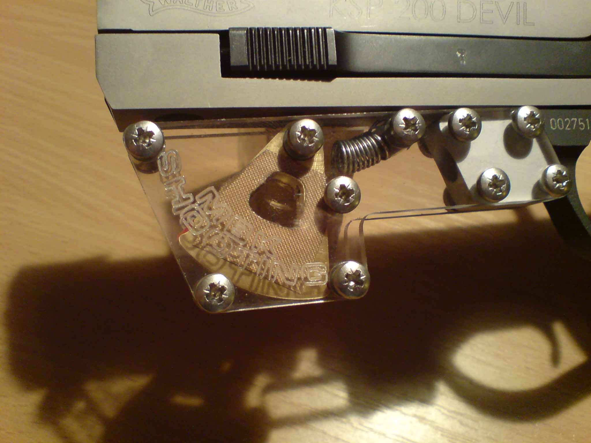

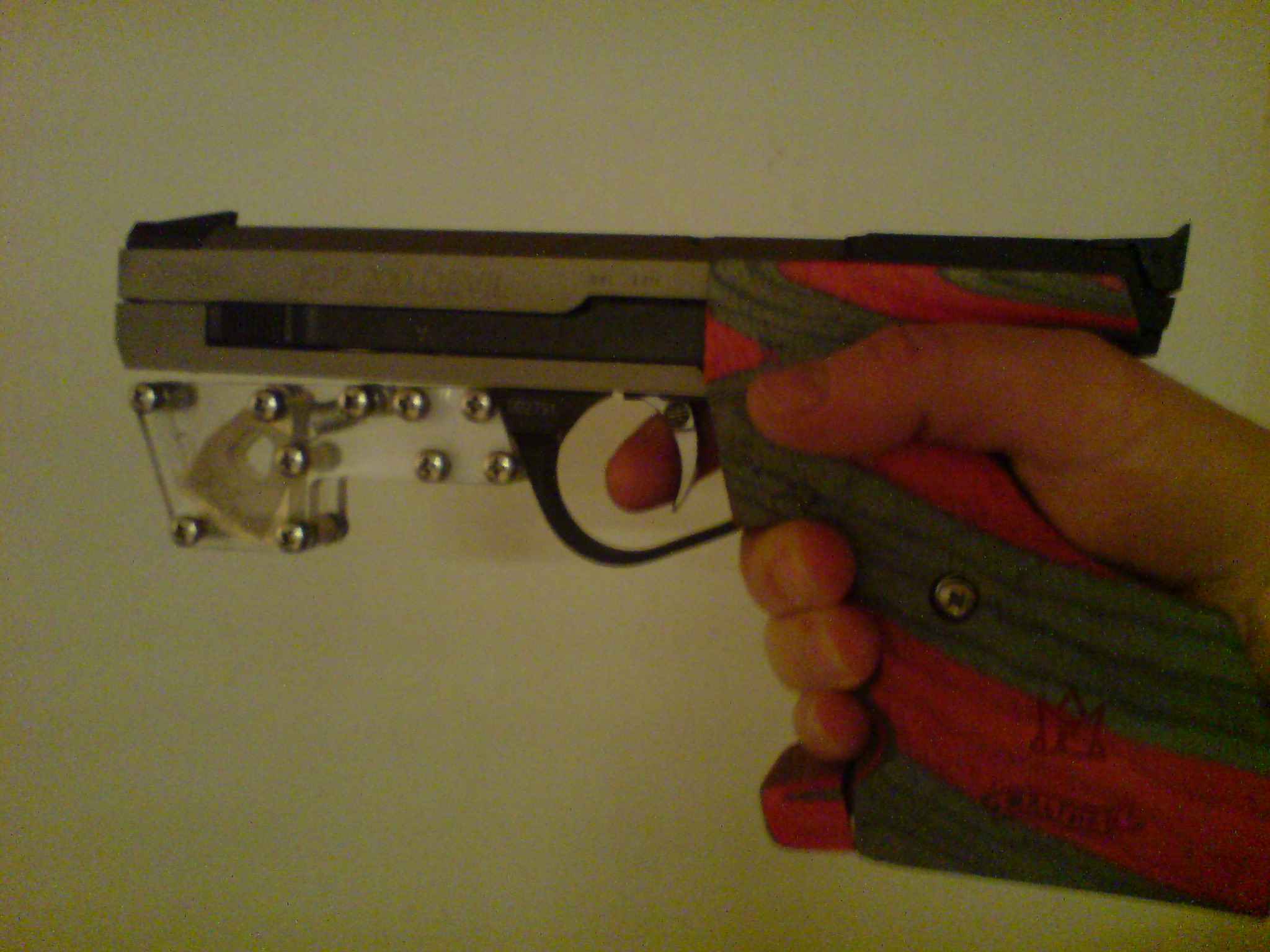

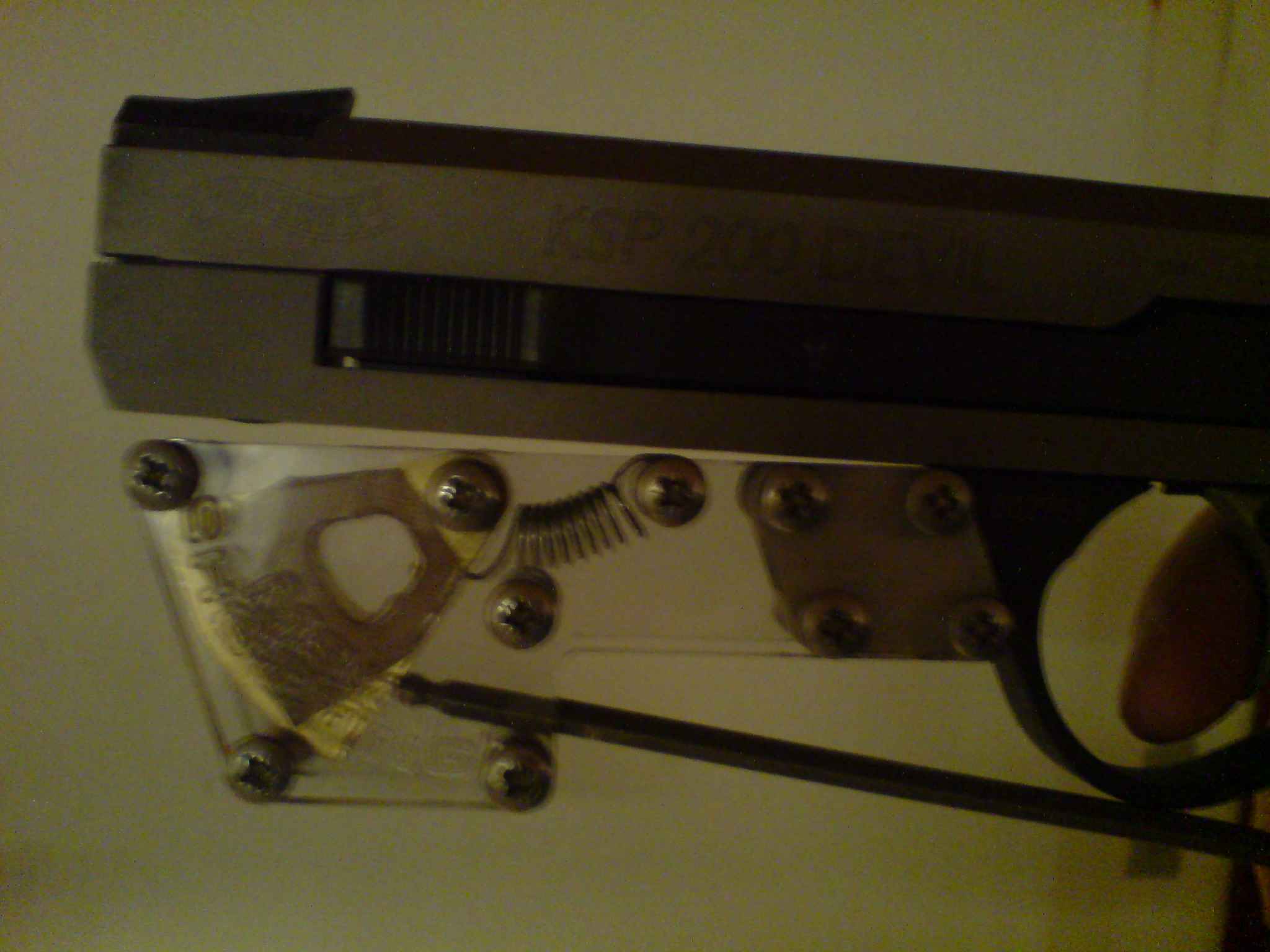

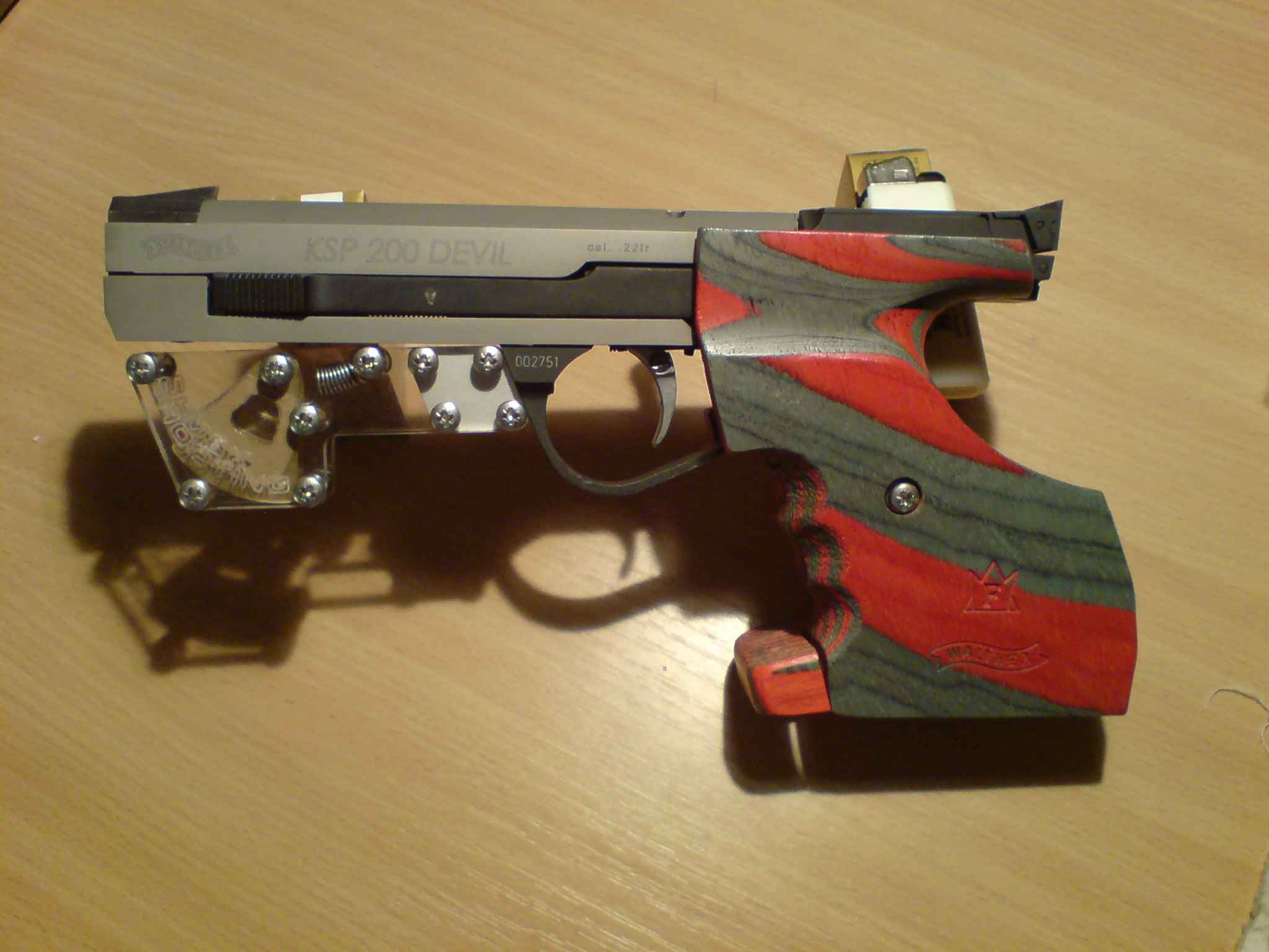

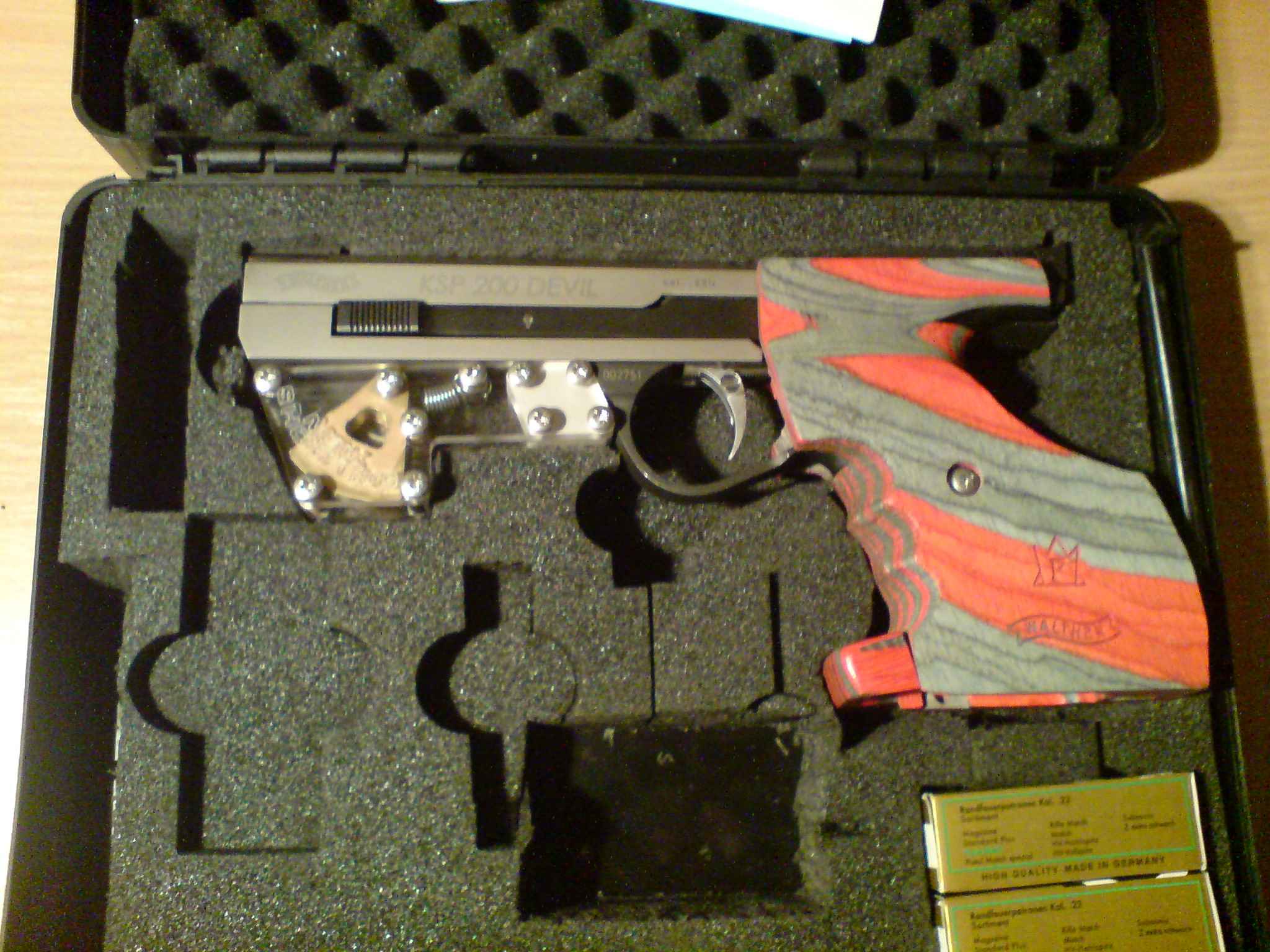

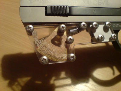

Here's my revolving barrelweight mkI
Finaly I managed to finish my barrelweight.
The weight is made of brass, sides of lexan, base of aluminium(suface-treated), spacers stainless steel+brass.
Unfortunately the spring is too strong (rigid?), so I do not have any movement yet. Still it works fine as a weight, brought the gun up to 1340 grams including a empty mag. Sorry about the quality of the pictures, taken with my phone.
Mikkel
Mikkel
