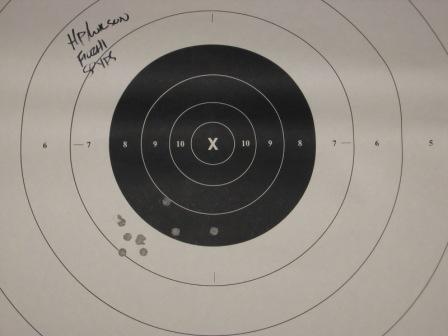

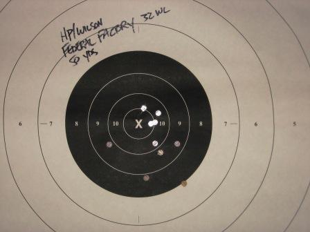

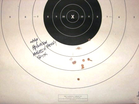

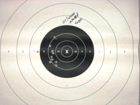

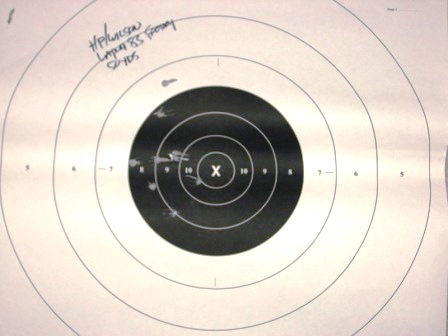

The brass reloaded fine, but the factory ammo was definitely 'warm.'
It chronographed at 730 fps out of my HP, which is over 100 fps faster than the Fiocchi, PMC, and Magtech ammo. It was the least accurate of the bunch as well.
50 yard targets attached.
- Fiocchi

- Federal
- HP_Federal.JPG (19.18 KiB) Viewed 1939 times
- Lapua 83gr
- HP_Lapua83Fac_c.jpg (35.12 KiB) Viewed 1939 times
- Magtech
- HP_Magtech_c.jpg (35.2 KiB) Viewed 1939 times
- Magtech#2
- HP_Magtechb_c.JPG (36.8 KiB) Viewed 1939 times

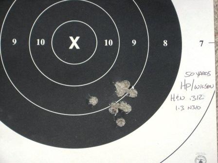

All targets were shot from sandbags using a 1x red dot. Shooting a .32 at 50 yards seems to be an entirely different proposition than the 25m game. It is possible, but does take a little homework.
I tested two factory barreled pistols at 50 yards, a Hammerli 280 and Pardini HP. Both were hard pressed to keep 10 consecutive shots within the 8 ring.
My current HP has one of Dave Wilson's fast twist barrels in it. (Screen name 'fc60' in the post above yours.) None of the factory ammo did very well at 50 yards for me, although the Fiocchi, Magtech and PMC held X ring at 25.
However, attached is a typical group from the match handload, which took a few months of testing to figure out but costs less than $4 per 50 to reload. Sub 2 inch groups are common.
There are significant advantages to shooting the .32 instead of a .45 at the short line. On the downside, crosswinds can be a problem at 50 yards.
If you plan to shoot more than 25m, I highly recommend one of Mr. Wilson's barrels. (Not a spokesman, just a very satisfied customer.)

- HP_HN13.jpg (21.45 KiB) Viewed 1837 times
That is a pretty amazing target for a .32 at 50. Dave you are the man. I came to use the same 1.3 gr VV310 in my FAS and it shoots like gangbusters at 25. Plus I use the same .312 bullet, anything of bigger diameter just leaded up immediately. Even at slow speed of 1.3gr.
