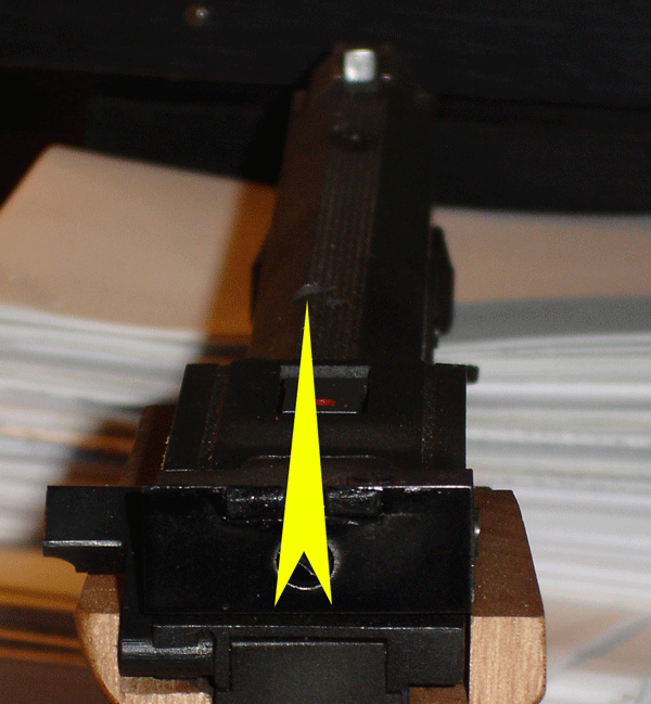

paulo
Posts: 338
IZH Rear Sights
Post by paulo »
Rear sights for the IZH 35M with a triangular shape, since the slant on the sights is hard to see I superimposed a yellow arrow to help give an idea of the angle I used. It is not much but it helped me, it might not work for others.
