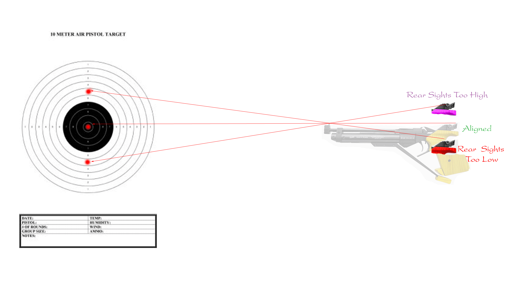

Now, MY screw-up. I was trying to shoot in my oversized garage. I have 30 feet to shoot in, but the 46M shot high at this range. I began raising the rear sight and this is a pleasure. There is a nice convenient knob for this in english, but when I moved it up all the way, well, there is nothing to stop going past all the way. The cool little click-stop is a spring in a cavity in the gun's chassis with a ball bearing on top of it. What keeps it inside of the tube, cavity whatever is the pressure against the knob. I got the knob too high and the Ball bearing went into the puckerbrush, and since I estimate the diameter of the bb at something between 1 & 1.5 mm od I didn't expect to find it.
So, you shooters of this pistola, should it be adjustable at 30meters? If not do you recommend grinding down one of the extra foresights or redrilling the extra rear sight? I really don't want a red dot sight, too much weight.
Pat McCoy
Posts: 806
Post by Pat McCoy »
The IZZY Is adjustable at thirty feet (not meters), and if you were shooting high, you should have been lowering (not raiding) the rear sight. Always move the rear sight the direction you want the shots to go on the target (but I haven't yet figured out how to "shrink" the rear sight and the group :))

Don't mess with my brain! Okay, sort of kidding. But I am ambidextrous and things like left-right up-down can confuse me. (Try suddenly realizing that you're writing mirror image from right to left for the last 20 minutes and see what it does for you)
I just checked again and "Down" on the knob moves the rear sight down. This will move line of sight up, not down. Just to be sure I'd take a large box and just move the adjustment both directions just to check my sanity. Some sights "Up" means shot up while others mean sight up. I think that this means sight up. Not to doubt, but are all of the comentators speaking from experience with the 46m?
My understanding is that 30 meters is a standard distance for air gun competition so 30 feet should be within what it's designed to do, or so I thought. The do it yourself grip and extra parts makes me wonder if this isn't something that is customizable as well.

Moving the rear sight down will cause you to shoot lower (as you must then lower the front sight to get it back in line with the rear sight).

This rear sight adjustment thing is new to me. Weird to say for someone who has shot competition for many years and hunted. HUnting I use a scope. When you move up or down who knows what goes on inside of there?

I am with child to try out the "new advice" on the sighting. It's embarassing after shooting for 40 years but I'm not proud. As I've said many times detailed basic instructions are rarely a mistake. It's a good lesson about how many skills we learn by "show and do". If I find some easy way to get this bearing in I'll tell you.

Hi Drmarkway, ONE more time...Move the rear sight Down to move the
pellet impact point DOWN! (not sorry for the shouting!) The official ISSF
air pistol competition distance is 10 meters. I know that you'll learn to have
great fun with your Izzy. If you draw a crude representation of a barrel and
front and rear sights on a piece of paper; then draw a line touching the top of the sights,
and then vary each sight dimension, redraw the line of sight
and you'll immediately see the adjustment relationship......Just trying to help
you here....

Thank you very much. Your post of some days ago jogged my mind into motion. You have no idea how humbling this is for a man with a Phd, 25 yrs as a hands on electrical contractor and service person, three inventions, almost my whole life exposed to firearms, able to perform tricks with pistol point shooting and to not know this thing, well, it's incredible.
Most powder/conventional firearms use either a scope or opeate at quite close range. Most real pistol work takes place at 30 feet. The sights are essentiall fixed. Adjustment of a pistol's sights is possible but really long distance shooting is done with a rifle and a rifle means a scope, or quite frankly, point shooting. The trouble with being good with a hammer is that most problems begin to look like nails.
The graph is very like the one I would have used to prove to you that the rear sights must be moved UP to lower point of impact. If you treat the gun as a picture you can easily see that the front sight being constant, raising the rear sight shoots your line below the horizon line. That's the problem with a diagram. What is absolutely essential to remember or notice, MY huge mistake was in forgetting that the gun MOVES. That being the case, lowering the rear sight causes the shooter to raise the rear of the firearm, lowering point of impact. I stand under correction, but moving the rear sight to the left moves the barrel to the right, right?

Notice that is you follow the purple gizmo the line descends below the horizon DOWN. If you forget that the gun moves raising the rear sight gives you a SIGHT PICTURE that is lower. What it does NOT do is lower the point of impact.

A little grease is better than glue in this application, like peas and mashed potatoes on your knife.
It's generally better if you own several guns to note the threads and which direction knobs move the sights.
Most American equipment moves the point of impact higher if turned toward the "H", or to the right if moved toward the "R", but some German and Russian sights mean turn toward"H" if it's already hitting too high, or toward "R" if hitting too far right. I 'bout lost my mind with a Schmidt und Bender variable on a very expensive Hornet before I figured that out.
If you just watch which way the REAR sight moves, you're fine, regardless of how it's marked.
Front sights are exactly opposite.

I was totally wrong and was not defending that incorrect position. I was showing you how I fell into error! I am totally grateful for your information and feel the need to reiterate the benefits of having an instructor who really knows the mechanics of what is going on, and who can say, "Whatever the adjustment knob says, the sight has to go THIS way."
Reminds me very much of a conversation I had with my son over cell phones. HE says that they are easy and any moron should be ableto figure one out. I have two MA's and one PhD, and used to own a Motorola "Brick", own an Apple Ipod, and say "No."
He says that if you know what you want to do on these phones and where to look for it, it's a snap. He's almost certainly correct. The important point is knowing what you want the thing to do and knowing too what it's capable of.
I used the diagram not to prove that I was right (Heaven forbid), but how I went wrong. Raise the rear sight the line goes down, ergo raise the rear sight. Absolutely wrong, but that's how I interpreted it. Windage instructions ARE opposite. Move the sights left and point of impact moves to the right. More confusion, unless you know how it works.
As Frog pointed out these controls are not universal, which adds to the confusion. Be honest because I want to know; did you figure the whole thing out on your own or did someone instruct you?

drmarkway wrote:I Windage instructions ARE opposite. Move the sights left and point of impact moves to the right. More confusion, unless you know how it works.
Sorry, windage adjustments are the same. The rear sight always moves in the direction of point of impact whether it is for elevation or windage. You move the rear sight left and the point of impact moves left. Move the rear sight right and the point of impact moves to the righth.
