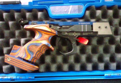

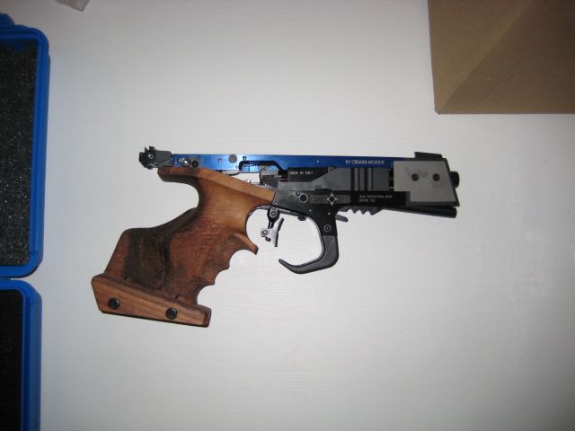

I own a MG2 with a large Rink grip and I am very happy with it. Lately though I have been comparing it to some pictures of the MG2 with the factory grip. It seems that the Rink grip moves the hand further back and down compared to the factory grip. In theory this should be a bad thing regarding recoil uptake. My factory grip is long gone so I am not able to compare them on the range.
Does anyone have any expirence with this?
MG2 with factory grip
MG2 factory grip.jpg (32.58 KiB) Viewed 2441 times
MG2 with Rink grip
MG2 with Rink grip

It's hard to tell from the photos that you posted.
However from what I can see there appears to be a negligible difference between the 2 grips.
If anything I would say that the hand is closer to the gun with the Rink grip caused by the different trigger on the newer version than the old one.
To my way of thinking that might be more of an issue.
TB
Posts: 236
Location: Denmark
Post by TB »
Sorry, but I fail to see how the trigger effect the position of the entire hand except for the trigger finger. Besides, I use the trigger on the first picture now, the other one has IMHO a wrong angel. The Rink grip definetly moves the hand further back and down compared to the original grip, the question is how big a difference it makes when shooting.
