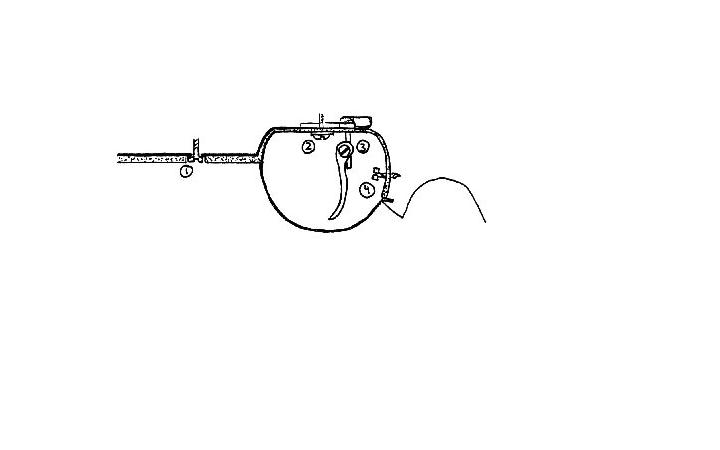

Toz 35 trigger adjustments
Screw 1 Trigger Weight- Turning clockwise increases the weight.
Screw 2 Trigger Position - Loosen screw to rotate the entire trigger unit for side-on finger application onto the "finger pad" - this also allows forward/rearward adjustment of the trigger for longer or shorter reach.
Screw 3 Vertical Position - Loosen to set the height of the trigger.
Screw 4 Sear Engagement - Clockwise decreases the amount of engagement.
Have you tried adjusting Sear, number 4 on the image?

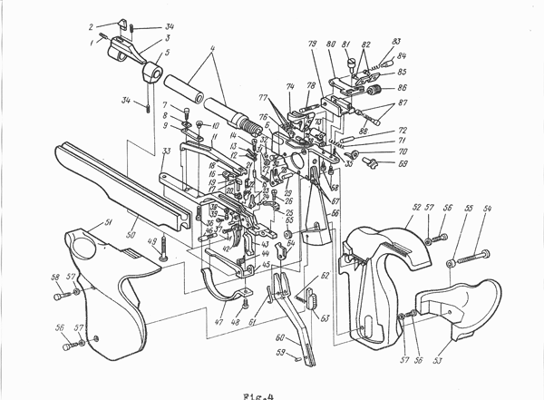

Don, these things are complicated, and terminology can be a problem. Do you have the factory 'manual', with an exploded diagram and parts list?
Let's assume you are new to the TOZ, and don't know too much about them. If this is wrong, forgive me, but it's better not to presume...
When you cock the firing mechanism by moving the loading lever forwards, does the extractor snap loudly backwards? If not, and the thing isn't defective, you aren't moving the loading lever far enough forwards.
When does the 'striker' (=firing pin, I assume) 'come forward'? Do you mean that it moves as if striking the cartridge, or does it move smoothly as you move the loading lever back? In other words, did it cock, and then release, or did it fail to cock? In the first case, the loading lever should not be loaded by the mainspring when returning rearwards; in the second, the mainspring will be trying to move the loading lever rearwards. If failing to cock, you may not be moving the lever far enough forwards. Cocking happens only at the extreme limit of loading lever movement.
Another possibility, which may account for both of these behaviours is if the spring which bears on the underside of the sear may be broken or weak. (Part no. 70 in the 'manual' = 'sear spring'). You should be able to see this through the square-ish window in the left side of the frame: a silvery flat spring running from the back face of the breech block, and curling forwards along its underside, visible just behind the back of the loading lever, when the lever is back. Also, having removed the left grip, there's nothing to limit the forward movement of the loading lever. Try it - did that help?
There is no adjustment for sear engagement. The complicated set trigger's function is to kick the sear out of engagement via a little lever lying between the trigger mechanism and the sear (part no. 76, 'sear lever').
Hope all these words help, and that you're still awake.

I had a bullet burst in the chamber, and the force broke part 69, I fabricated a new one, and after installing it, the gun is not operating the same way as before, and it resembles the problem described, as the locking lever part 60 is always under tension now, and has a tendency to snap and lock under the spring tension all by itself, I looked at the schematics and it looks I have put the gun back the right way.
When I try to release the firing pin spring tension, as recommended for storage the lever part 60 stay in tension, but then after I open the chamber feeder the lever stays under tension and doesn't go limp and loose like before.
Thank you for all the suggestions, the ammo bursting was CCI and it doesn't chamber easily and I think the rim got crimped by the cocking mechanism and upon striking the brass was to thin on the bottom of the bullet and it burst a whole on the back of the bullet.
I was able to repair the gun, spring part#70 was not applying enough force to the firing pin spring lock mechanism, bent it a little more towards the firing pin lock and it is working fine, your problem should be solved the same way, unless yours is broken. There are images on this site for solutions on how to make a spare spring part#70 from a paper clip just do a search.

This then raised another problem. Adjustment of "screw 4" in the TenP adjustment file would not cause the pistol to fire, and the side cocking lever would not reliably cock the trigger until "screw 4" was completely removed from the pistol.
