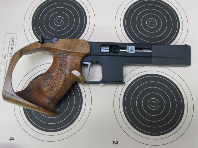

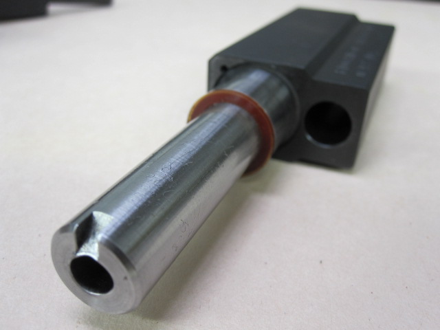

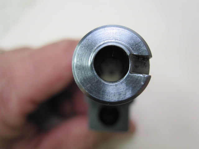

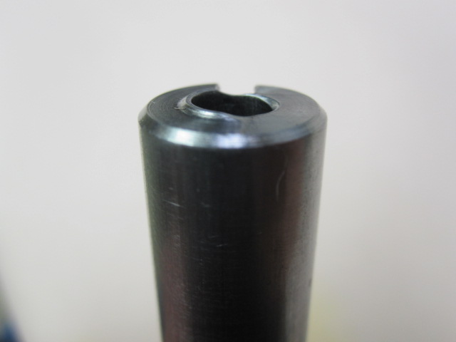

I have aquired a GPO Rapid Fire pistol in 22 short. It appears to be in great shape but after a closer look, I may have a barrel chamber issue?
You can see by the photo that there is a "ridge" along the top half of the chamber opening and the chamber appears to be slightly "oval" in shape.
Anyone have ideas as to how I would locate a replacement barrel for a Pardini GPO 22 Short??
OR can my barrel be repaired???
Not sure I can repair the barrel I have, but it would be nice to have a source for a new one.

I am not a Pardini expert but it looks possible that most of that should be like that to make it feed well.
check your spent brass for bulged brass towards the rim and an oval shape there... if it appears round and not bulged check the accuracy of the barrel. If it shoots well you may be chasing a problem that may not realy be a problem.

Actually, that was my thought as well. I have not checked the brass, but it seemed to be very accurate when I shot it yesterday.
Since the barrel does not have a feed ramp, I was thinking that possibly it was manufactured with this shape to aid in feeding as you mentioned.
But why the "Ridge" along the top edge of the chamber opening? Was this intentional to aid in primer ignition? Or formed by lot's of rounds being fired through the pistol?
As I have never seen another GPO 22 short around, I have nothing to compare it to???

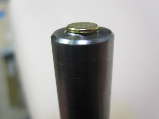

Photo with cartridge in chamber....
Post by THREEDFLYER »
Here is a shot of the barrel with the cartridge in the chamber....notice the ridge at the front creates a space under the cartridge rim on the lower have of the chamber opening.
Being a 22 short chamber, I have not idea if this is intentional.
Tom

The "feed ramp" is the follower in the magazine---remember .22 RF guns that shot the short ammo are notoriously a swift pain the arse, to say the least. The guns are extremely picky as to the ammunition they will digest as well. The event used to be notorious for the continuous frustrations due to multitudinous malfunctions (failures to feed, extract & doubling)followed by lots of "alibi" rounds. From your pictures of the round in magazine I personally see nothing amiss, your barrel picture were of no value in making any type of decision. Now I know .22 short ammo isn't easy to find and there are lots of brands out there---but, I think you ought to try a few before you through in the towel. This is an "old" version of the Pardini RF pistol. I would say, use the gun for Indoor Bullseye, except the grips and the trigger won't pass muster. "Doc"

I have four Pardini .22 short pistols, and all barrels have always had that lip. Don't ask me what it's good for, but it works.

Thanks Tycho for posting.....I was hoping a guy like you would come along and verify that the "lip" on the chamber mouth was part of the design.
