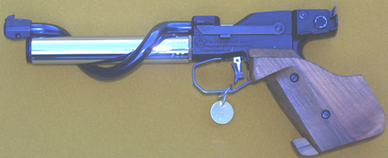

No need to worry if you think you went too far, this one suposedly shoots good.
Here's a FWB Model 2
