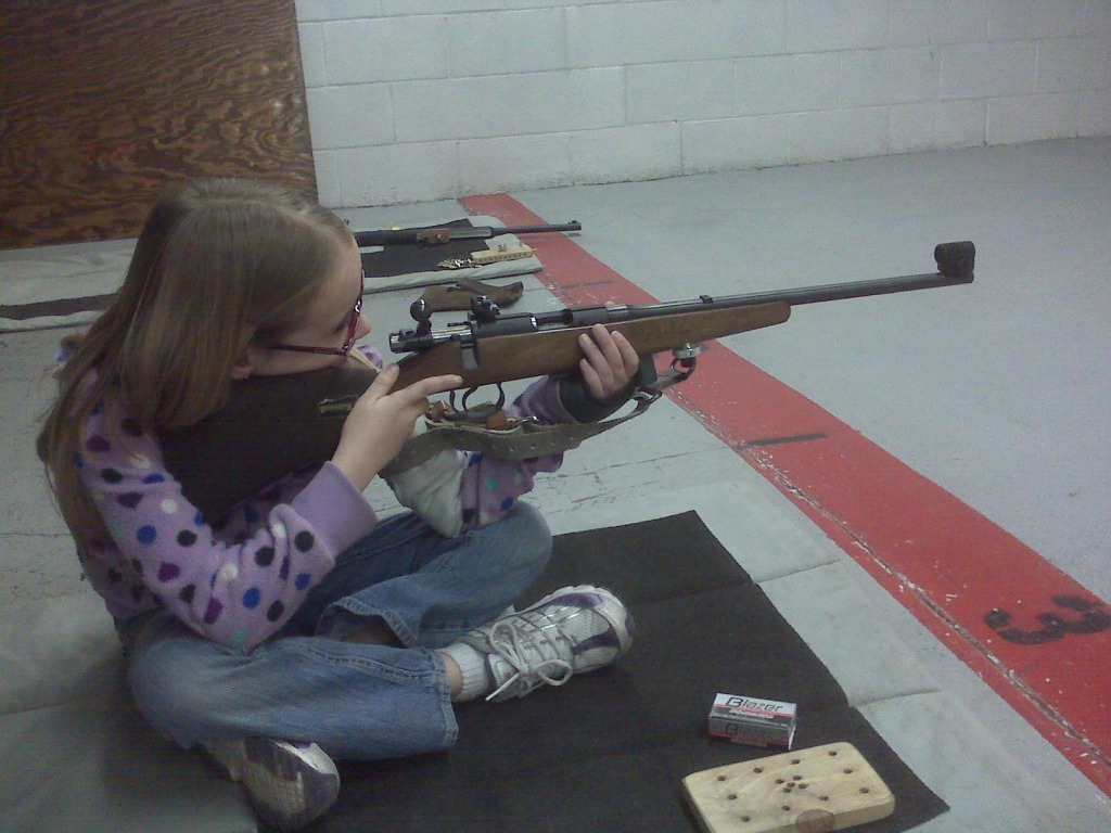

How do you determine the correct front Aperture Sight insert size?
Is there a formula to determine the correct size?
The smallest aperture in my set is 3.2 and it seems much too large.
My daughter is shooting a CZ 452 Scout. It is a small rifle that the Eye-to-Front Sight distance is only 24” inches.
She is Shooting A17 NRA targets at 50 Feet.
Thanks for the help

The January/February issue of USA Shooting News has a chart on page 8, for "minimum" aperture sizes. Unfortunately is only goes down to 28" of eye-to-front sight radius. For A17 target at 28" it shows minimum of 3.0 ( with 3.1 at 29" and 3.2 at 30").
Using this as a guide you MIGHT try as small as 2.6 diameter at 24", but try a 2.8 also.
Hope this helps.

Thanks for all the help.
She settled in with a 2.7 and shot well.
Her scores were 427 out of 500 on A17 Targets in practice at our range, and a 389 in competition last weekend in Grand Junction, great for an eight year old, in a new range.
