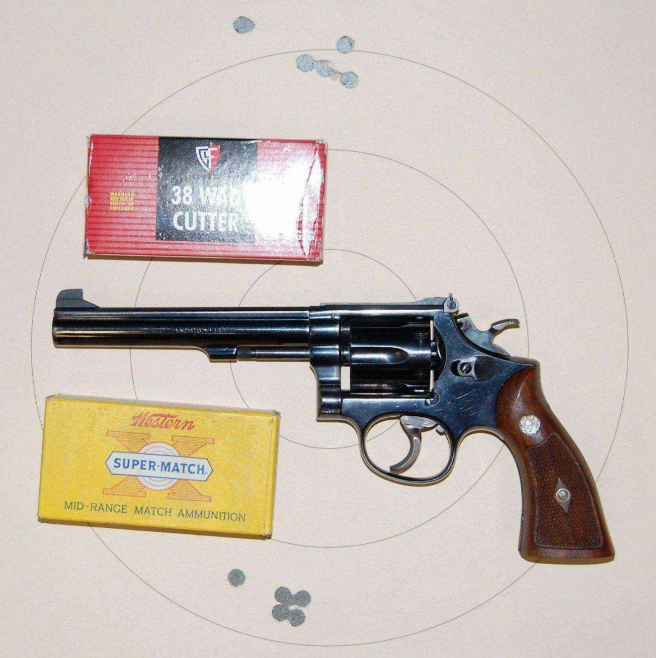

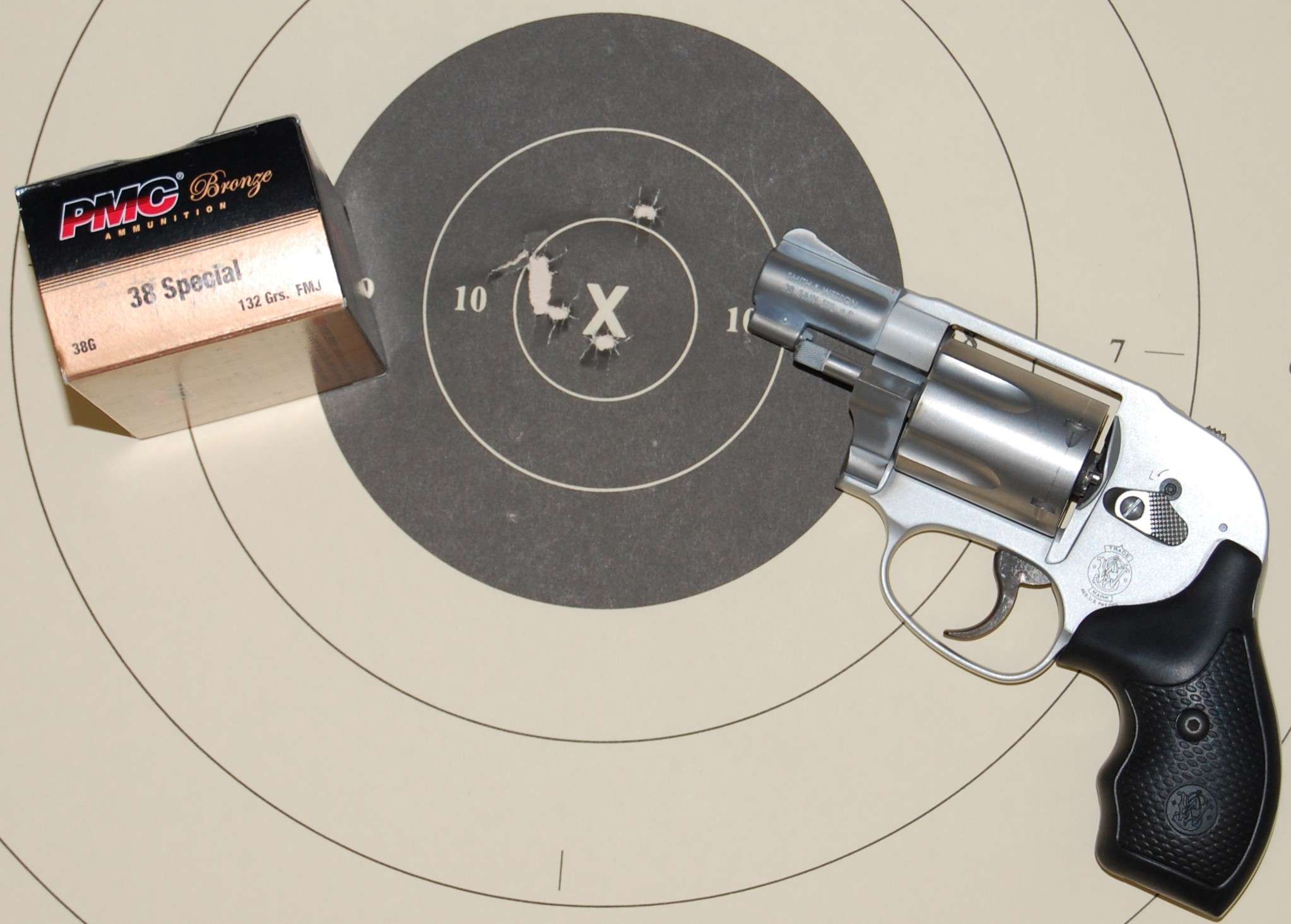

Testing part 1 – Materials and setup.
Post by BenEnglishTX »
I had time to do a bit of testing today, so I headed off to the range. I took three boxes of ammo: 130-grain generic ball loads from PMC (standard range-bought practice stuff), a brand-new box of Fiocchi 148-grain HBWC, and a box of Western Super X 148-grain HBWC that dates back to the 1960s. I'm not sure of the age of the old ammo but the point is that it is several decades old.
Back in those days, as we all (should) know, 148-grain HBWC ammo was loaded hotter, in the 850 to 900fps range. Currently, I believe the last chronograph results I saw for Federal ammo had it at barely over 700fps. Elsewhere on this board, for example, a poster is talking about his Model 52-1 and he says that new Fiocchi won't cycle the slide. The Western ammo I used was produced back when .38 wadcutters would make that pistol work.
To simplify matters, I used only two firearms: the M638 that gave me the most trouble previously as well as a S&W M14 single action. (Nice, nice revolver, that M14. I really like it.)
I was unable to find any premium targets to shoot. I shot the writing-paper thin targets available at my local range as well as a couple of D1(T) targets out of a fresh box I had at home. Neither source of targets should have spent so much time exposed to the local high humidity for that to be much of a factor.
All testing was at 7 yards. I paid no attention to trying to shoot small groups; I just wanted to see bullet holes.
The first picture is just a baseline. It was shot with the snubbie and the PMC ammo. It's only included to show that, yes, I can hit the target if you put it close enough.

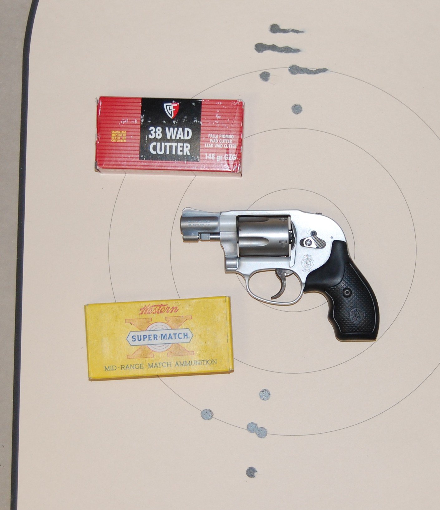

Testing part 2 – A snubby and wadcutters

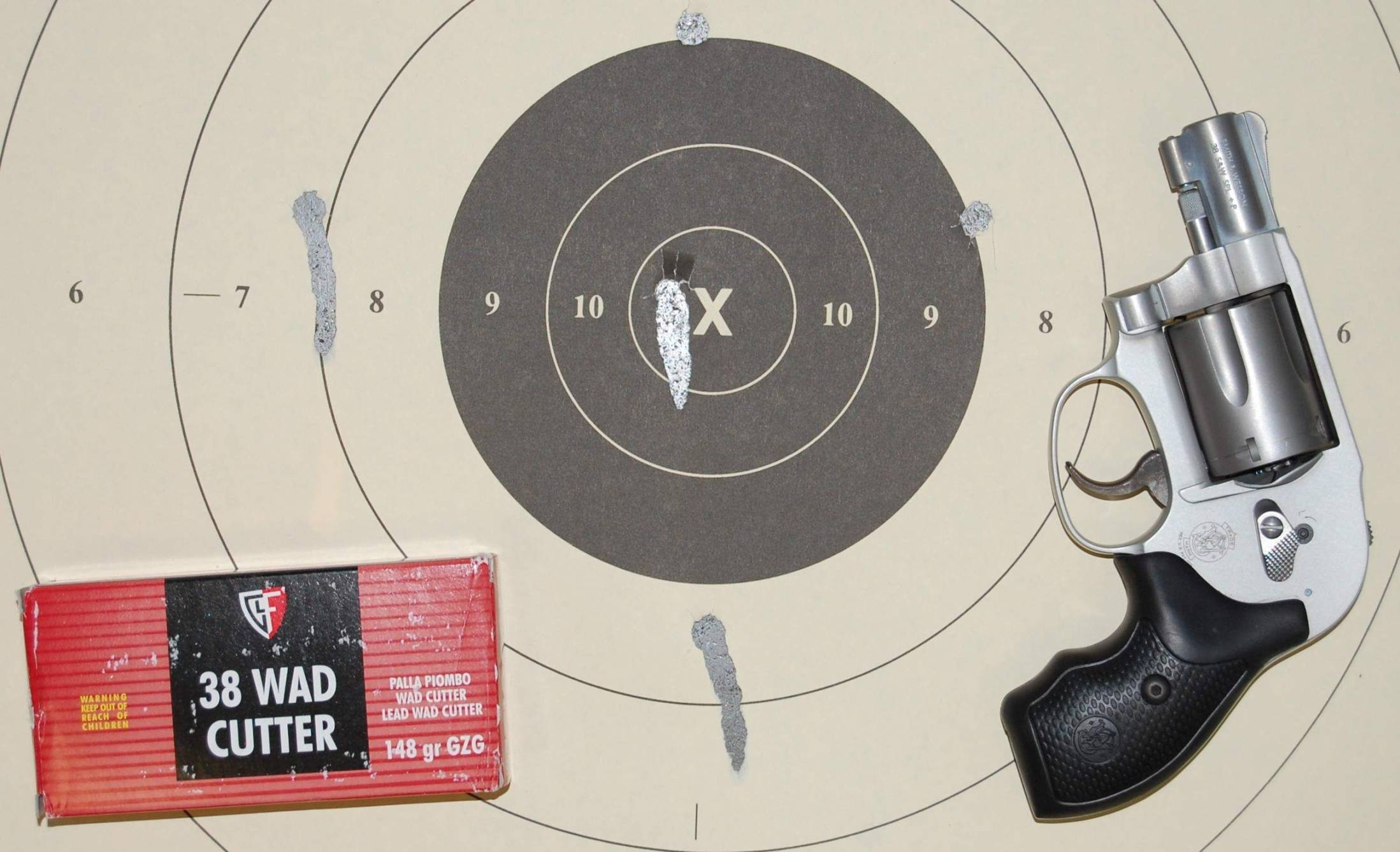

This first picture shows what happens when I attempted to put shots at 3, 6, 9, and 12 o'clock around the black as well as one in the center of a range target, using a new box of Fiocchi and the short-barreled revolver. Clearly, in a defensive shooting practice scenario where 20 or more shots will be put on one target, the long tears shown here would make the final target look nothing like a target with bullet holes. The result would be a shredded bull without a distinct pattern. This would also appear to the shooter as very bad accuracy.
Note also that the two “round” holes at 3 and 12 aren't exactly round.
As an aside - the accuracy, here, is not good but it's better than I expected. However, I contend that my original accuracy complaints are valid. For example, the range session that led to my original post had included one heartbreaker of a group at 25 yards, using a 3-inch pistol. In a 5-shot group, 3 shots cut perfectly round bullet holes as close together as any three shots I've fired in my life at that distance while 2 more landed a foot high and tore long strips from the target. Bullets that tumble so much that “tipping” is evident at a mere 7 yards are, I think we can agree, anathema to good accuracy.

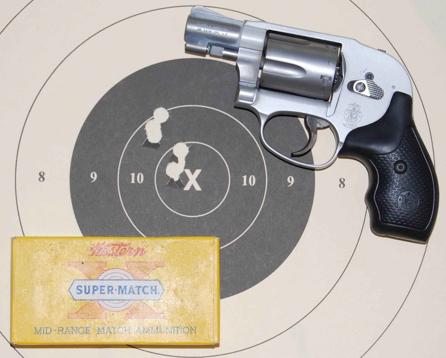

The second picture is the same gun and same type of target but using the old, faster Western loads. Note the perfectly round bullet holes, just like we expect from wadcutter ammo.
The third picture is two groups on the same D1 target using each brand of ammo. These are slightly higher quality targets so the tearing is slightly less evident in the Fiocchi group. However, the difference between the two is still obvious. The old ammo works in this gun and the new stuff doesn't.
I did not chronograph the 2 loads used. However, by this point in testing the difference between them was painfully obvious. The older ammo was clearly hotter, recoiling noticeably more and more sharply. This was not a small difference. The felt difference in my hand was easy to discern.
