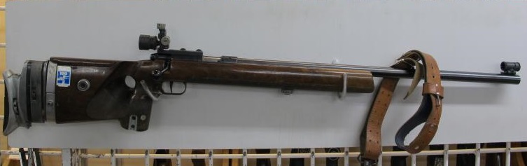

Can you identify this rifle?
Anschutz is the manufacturer, and it has 2,4cm thick 680mm long barrel.

Hi Jiri,
The rifle appears to be a 1613 Supermatch. This was the predecessor of the 1813. Date of manufacture is probably 1979 as the bolt handle is curved, but could be '78, or even 1980.
I cannot be definite of the model and date, as a 1979 vintage 1613 barrel and action looks almost identical to an 1813. There are some differences in the bolt, firing pin, and trigger, and of course the markings on the barrel. But these cannot be seen from your photograph. The differences between the two rifles are relevant for spare parts, but not really for shooting.
The stock is certainly the older 1613; an 1813 has a larger triggerguard to accomodate a stack of belville washers under the bolts (the 1813 is also more square in shape). An extra piece has been added to the stock to make it longer and add weight (the butt can be lengthened with a screw thread). The buttplate has been installed upside down.
The rearsight looks to be a little newer than the rifle; I think it is a 6802 from the 1980s or '90s. The 1613 would have come with the 6702 rearsight. This is a small point; the 6702 and 6802 are practically the same. The 6802 has larger adjustment turrets, and smaller screws on the clamp. The rearsight could be a 6702, with 6802 turrets.
The 1613 is a very good rifle; there is a persistent (but incorrect) legend that the X at the end of the serial number means the barrel was selected for superior accuracy. It actually refers to the bolt and trigger, which had been redesigned a few years before. Even if not selected, 1613 rifles have the reputation of shooting well (if in good condition).
Tim
p.s. The barrel should be 69cm long, measured from the face (inside the action) to the muzzle.
Tim
Tim, thanks for info.
That rifle has asking price of 250€, so it is a lot more than 75€ for that finnish lion but I think it is still cheap.
If both rifles are in good condition, which one would you recommend me to buy?
I just called the seller. Seems there are no model numbers etc. on the barrel or frame.. Is this normal?
Hi Jiri,
first, it seams to me 250 EUR is a real good price for an good Anschutz Super Match like that. Here in Germany the street price for such rifles is normal not under 500 EUR and most of them have then only the Standard stock.
You can watch the German internet auctions site http://www.egun.de for comparing the prices. Most sellers there are serious but sometimes it seems to me, there are also some people out, who are pushing the prices artificial. Some of the sellers there are also willing to sell to other EU states, but beware, there is some paper work required because of the often really crazy and different weapon laws.
Tim S gave as always a really good summery of the rifle. These rifles are normal really sturdy and nearly all of them shoot very well. The only bigger problem could be a worn out or damaged barrel. But this is also seldom and it happens normal only after really heavy use over a long time. There are rifles out which shoot well after 100 000 rounds and more. If you can test the rifle before buying you can push a VFG patch through the barrel. You should than feel a steady retarding force on the hole way thru the barrel without interruptions and this force should also increase a little near the front of the barrel. Although this test is not an absolute proof it is an good indicator.
My personal opinion is on the long run you will be much better with buying an used Anschutz like the shown then with the Lion. The Lion is surely not bad, but you can find easily all spare parts and nearly all modern accessories for an Anschutz and you can also easily find an newer or custom made stock. But the last is not a must, because the stock is not so far away from the newer stocks if it comes to ergonomics and individual adjustment and this is an other point against the Lion. The Anschutz 1X13 Super Match is as jet the most successful match rifle of the world and there must be a reason for. I'm also a longtime owner of an Anschutz 1807/1813 and if it comes especially to prone shooting i prefer the wood stock still against my newer Alu stock from Keppeler, which on the other hand for me works better for 3P.
The reason for the not seen model number on the barrel could be just a communication problem between you and the seller. For rifles like the only unofficially so named '1613' there was no real number on the barrel, only the text 'Super Match 54' or 'Match 54'. Only the newer models like the 1813 had the model number direct on the barrel. But there must be a serial number on the left front side of the action and some proof signs. The two letters near the German eagle sign will give you the coded date of the official proof testing and this is will give you also the approximate building year of the rifle.
An other reason for not shown a number or text on the barrel could be an exchange of the factory barrel towards an custom barrel, but i don't believe that. The shown barrel looks like the normal build in barrel from the factory.
Regards from Germany
Frank
Frank
