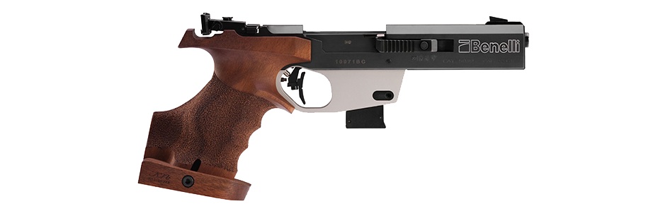

It's a good looking pistol. This is a pic of the latest 32, they have added a lot of adjustment features but removed the scope rail.

Everything I have heard has been very positive. I was looking to get one but held off due to all the differing opinions on the accuracy of the .32 SWL at 50 yards - not a MP90S issue, same discussions with the Pardini and the .32 SW. I am watching the Pardini .32 ACP with some interest.
