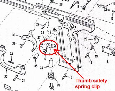

When I was still shooting Model 41's I had the same problem. My grip was so high on the gun that I would engage the safety right before a string of fire. Result- alibi after alibi. An old gunsmith provided me with a quick fix which stiffened up the safety enough that it would no longer engage just as a result of my grip. However, the safety remained fully functional.
One can find a good explanation of the fix, here:
(12th post down)
http://www.rimfirecentral.com/forums/sh ... p?t=276931
The instructions I was given state to remove the clip and bend it slightly downward.

m1963, thanks for the suggestion. It worked. I shot a match today no alibis.

I had the same problem with my 41. the safety has a small detent stamped into it. I removed it and judiciously
used a small pin punch to reset the detent. 6 months later it is still good.
