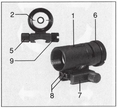

Hi David,
the front sight which comes from factory with the Anschutz 2002 SA is the model 6832.
It has two mounting screws (one is a dummy only for a better symmetrical look), a cant indicator, cant scale and the personal cant level is adjustable. Therefor it has two additional small lock screws in the front.
Not really sure about a name or sign on this front sight but as fare as i remember there was an Anschutz sign or logo. I have to look for it and can tell you then.
This front sight was first used and sold on the 2001 SA air rifle and on the 1907 and 1913 small bore rifles and it looks really different from the older models used on the 380 air rifle and the 18XX small bore rifles.
Here comes a picture which shows the 6832 front sight.
Regards from Germany
Frank
Frank

Thanks Frank! I had found the part number on the Anschutz website, but didn't know what it looked like. That is a much nicer sight than what came with it. No wonder I got this one. I think I'll have to post negative feedback on egun for the guy. He threw the rifle in a box and shipped it. No packaging. The stock was broken. I hope my repair holds. I'm looking for a new stock now.
