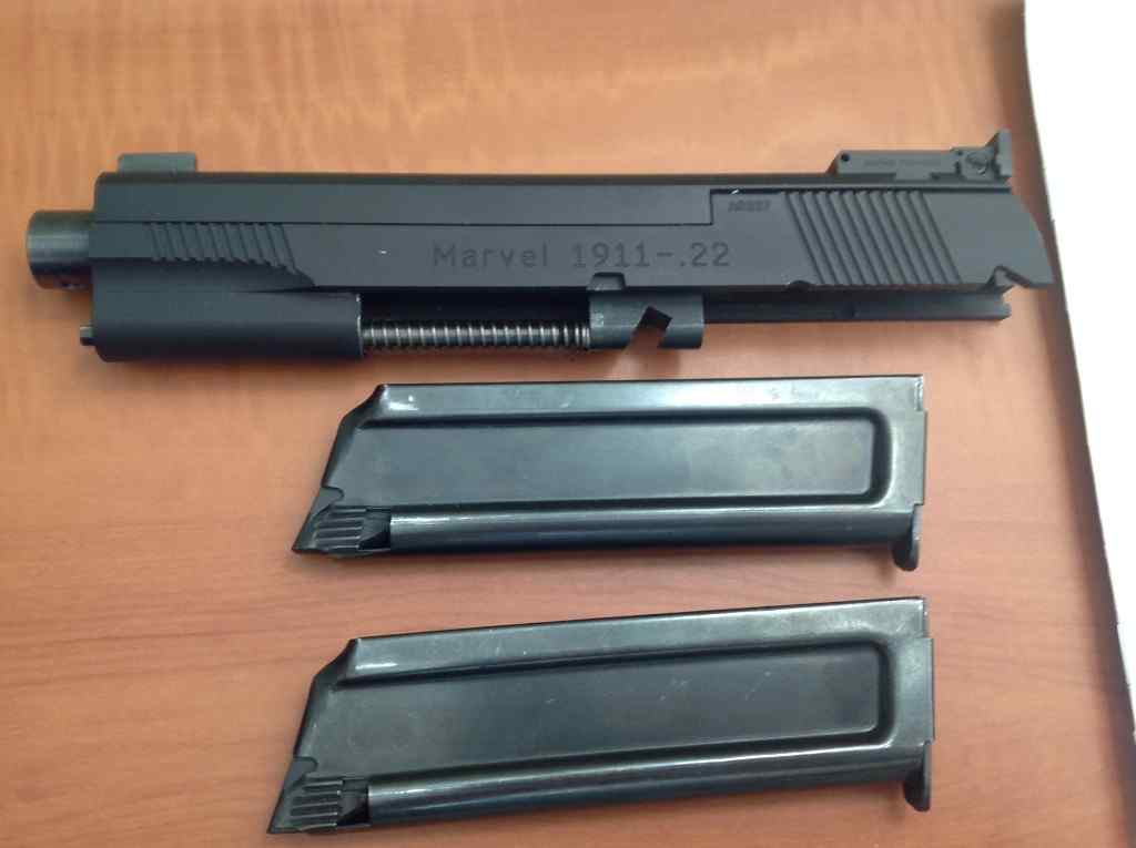

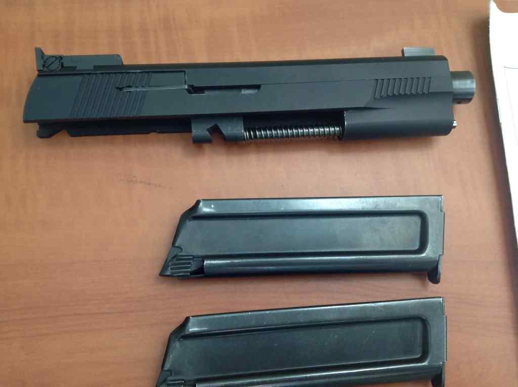

Thanks Jon, I would go with the Nelson, but I found what looks to be a nice deal on a Marvel at a local dealer, $250 only shot a few times. Is there a way to determine if it's a Marvel Unit 1 or 2 version? I've attached a couple photos.

Re: Marvel Conversion
45ACP;
That is a unit 1
Good price.
Clarence
That is a unit 1
Good price.
Clarence
