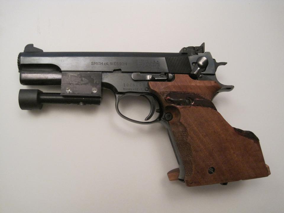

Is common opinion tha S&W 52 for a lot of people cannot get used to them because they are very unforgiving. I add a weight see photos and avoid completely this problem I had too..
- Diapositiva1.JPG (43.06 KiB) Viewed 2780 times

Yes, the addition of a forward weight does tame the unforgivingness substantially, but does not eliminate it. At least that has been my experience.

In my experience before I adding forward weight I could do a good series of 10.. some 9 and one or two 8 and even 7..in a standard 25 meters target in academic hold.. now is hard to go out of 9 ...only if I shoot with evidence mistakes from my part..

I have an opinion on "unforgiving" guns based on my personal experience. I believe that guns that are extremely light (my Margolin .22 comes to mind) or have extremely heavy muzzles (my Model 41 comes to mind) can be unforgiving in that if you make some kind of anticipatory movement as the shot is about to break, they will tend to make the shot worse than guns that have a more "forgiving" balance. Very light guns have little mass and so react very easily to any movement, and if the shooter's hand is not very steady in the time leading up to the break of the shot, they can make for a very poor result indeed. Guns with a heavy muzzle like the Model 41 can dampen minor movements very effectively and produce excellent results if the shooter is on his or her game; but if a movement anticipates the break of the shot a little early, the momentum of that mass at the muzzle can turn a poor shot into a major flyer.

Well now "light" at the front being the cause of the 52's moniker as unforgiving, makes sense.
