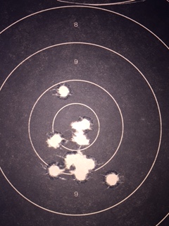

The only problem with finding a load your wad gun likes this much at 50yds,
Nosler 185gr JHP, Remington re-used brass, CCI primer, 4.7gr BullsEye.
4.7gr BE at 50yds.JPG (51.19 KiB) Viewed 3982 times
is that now I know all the 8s, and less, are on me!
Shooting off a rest using my red dot.

I know nothing about .45 calibre but, just out of interest, is this considered to be good grouping?

Considering it was hand held off a bench, using a red dot scope (no magnification) it is a decent group. I've fired the same load from the Ransom rest, from different accurized pistols, and 2" or less is generally what one can expect. I've seen one-hole groups at 50 yards (under an inch) with this load from the machine rest. A ten shot 3 1/2" group at 50 yards will keep them all in the 10 ring.

I was certainly happy with it. A grain less or more and the group is 50% bigger. And I called the high shot. With my astigmatism, the red dot is more of a figure eight and sometimes I center the wrong part in the black. 1.69" w/o that outlier. :-)

BTW Jabberwo, presciption glasses (fixing your astigmatism) will magically make your red dot round.

When gunsmiths test 45acp barrels for accuracy they can get sub 1" accuracy @ 50yds, but it's rare for the .45acp. A well built 1911 can produce 50 yd sub 1.25" 10 shot groups from a machine rest, but they are pricey. Most bullseye shooters would be ecstatic with a sub 2" gun.

For reference, the NRA conventional pistol target has a 1.695" X-ring and a 3.36" 10-ring (pretty close to one ring larger than the free pistol target, if that makes sense).
So a .45 that shoots a "2-inch group" is an X-ring gun, due to our baffling convention of measuring group size center-to-center while scoring based on inside edge.
Most bullseye shooters can't call their shots within 1 inch at 50 yards, so a 2" gun is fine, but typically High Masters are shooting .45s that are sub-1.5" at 50.

And jabberwo, I didn't mean to imply that yours was a bad group. I'd shoot that gun/load combo.

FYI on the astigmatism, I find a tiny aperture turns the hourglass red dot into a circle again. And, I can see the front sight, too. A lot cheaper than a new prescription.
