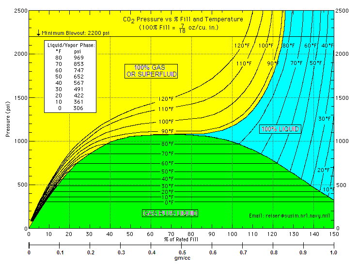

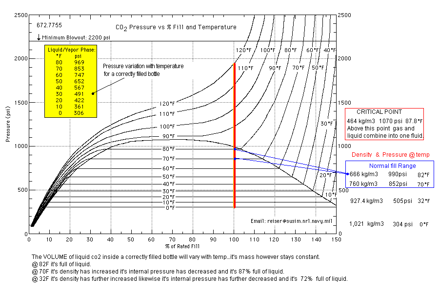

Here are some great charts that relate CO2 pressure, temperature, and state of matter.
Note that the horizontal scale is based upon rated fill of the tank. You can easily overfill a tank (dangerous to do).
They are a handy reference and can help explain why we shouldn't fill to overfill to 100% of available volume (100% of max full weight is generally ok most of the time).
Most CO2 valves are pretty self regulating over normal range of indoor "comfortable" shooting temperatures...
Car interiors on sunny days can become dangerous....which is why it is wise to ensure that any burst disks are properly sized at 1.8kpsi (1800 psi) and not 3kpsi (3000 psi).
I seem to recall that most C02 tanks are (max fill weight equivalent) filled to about 80% of volume, but the x-ray here indicates a bit more and closer to 90%:

so, I just fill mine to the stamped "full" weight...and if I should overfill, I drain the tank until I reach the Max fill weight--no matter how tempting it is to not drain the excess...My steel FWB Model 2 cylinders (circa 1983-84) work well to this day...and the FWB "new" one wasn't much newer, just laser engraved with a date about 3 years ago...pleasantly amazed that FWB still provides support to such an antique!

- co2pv.gif (20.26 KiB) Viewed 8751 times
- CO2_zpse4fc81d0.gif (19.7 KiB) Viewed 8751 times
