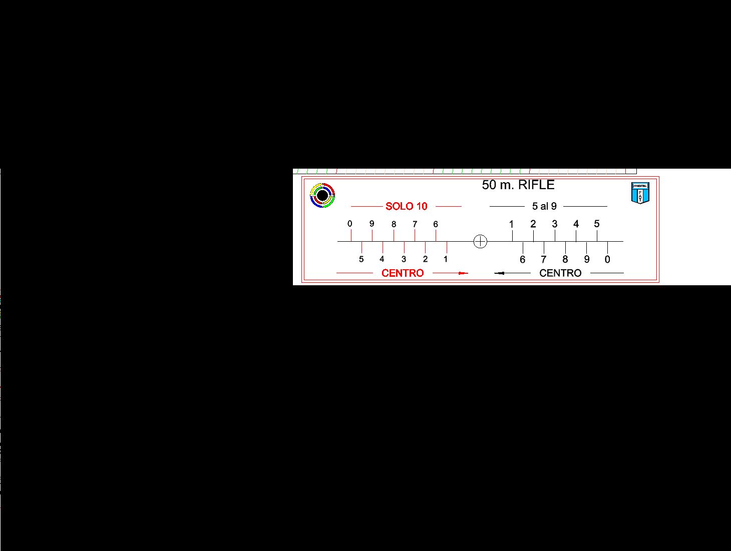

Here is the rule we use, sorry it´s in Spanis but it´s official.
You only have to print it on transparent media, and I strongly suggest you cover the printed side with a self-adherente transparent folio for protection and durability.
Good luck
Good luck

Thanks.
For calibrating printer does the 9 on solo 10 line up with 1 ring on target for 10.9?
Gerald
Gerald
Re: 50m decimal guage.
Exactly, you got it right.
