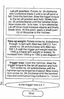

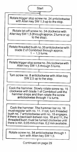

Re: SIG-Haemmerli Assembly
Greetings Jon,
A good start.
What are the parameters for adjustment?
i.e. Hold trigger back and move screw "D" until hammer falls then add/subtract 1/4 turn, or 1/8 turn.
Attached is the flow chart for the model 280 and, also, the SP-20 as an example of good documentation.
A good start.
- 280.jpeg (39.97 KiB) Viewed 2682 times
- 280B.jpeg (33.34 KiB) Viewed 2682 times

Re: SIG_Haemmerli Assembly
Dave I go by experience......what I want it to feel like. So I don't do any particular 1/4 turn etc until I get close to what I want. I know that doesn't help. For sear engagement I use Sharpie and blacken sear so I can see the engagement. The more engagement the more roll.
Jon
Jon
