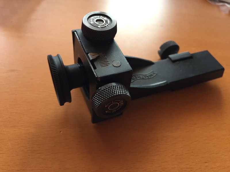

Post by Walnut92 »
Tim - it't not a Gehman. Here it is.
it's the knurled eye ring I need to undo to access the glass.

Re: Walther LGR - diopter sight question
Post by Albert T »
This is a standard old type walther diopter. The knurled ring with the two flat spots is screwed in the diopter and can be screwed out the usual way. The flat parts are made so that a special key can be used to unscrew it. The diopter has no glass. The knurled ring has an opening of 1.1mm and is sctewd into the block that moves sideways or up-down when the sightscrews are turned.

Walnut92 wrote: Sat Aug 24, 2019 10:58 am Tim - it't not a Gehman. Here it is.
I see. I was thinking it was a Gehmann because you mentioned glass. That's a standard aperture, a metal disc with a hole. There is no glass.
To remove it, grasp the back firmly and unscrew anti-clockwise. Alternatively buy a can of compressed air from an electronics shop and give it a blast.

Post by Walnut92 »
Brilliant, thank you both.
No glass - correct! Sorry, I perhaps should have looked more carefully!
Cleaned with cotton bud and all is good! Was very dusty and hence it was distracting the view even with only a pinhole.
