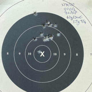

Thanks for the encouragement. You have always been very patient with me and my rants. I have fought fouling in my gun for the last couple of years. Previously I had poor results with lead which now I attribute to my loading techniques. Just for grins I loaded the rest of the T&B 62 gr LSWC that I had on hand to shoot just because I wanted to use them up. I made a few different load combos to use up the lead but it was mostly to confirm the proper trigger/sear operation. I was pleasantly surprised to see this result for 1.7 gr Tite Group. I was using just a red dot and a rest at 50 yds. Winds were generally pretty light. So now, I ordered some of T&B’s 64 gr coated LSWC to do some more load tests. Maybe the next test I will try to be a little more exact and consistent with aiming and see how it goes. I haven’t been shooting any matches in quite while as I have been working weekends but I have been mostly shooting my 9mm and .45 which are a bit more accurate. However, I really like shooting the .32 so I’m going to keep trying.
