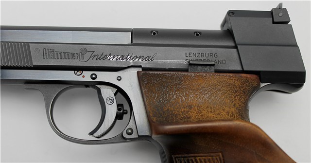

These pics are from GB.com. So somebody's done it at some point:
Dcforman
Posts: 89
Joined: Wed May 02, 2018 7:54 am
Re: Trigger Shoe-Hammerli 208/International
Post by Dcforman »
Looking at that pic, only one set screw is being used. I'm going to guess that shoe was not designed for a Hammerli.

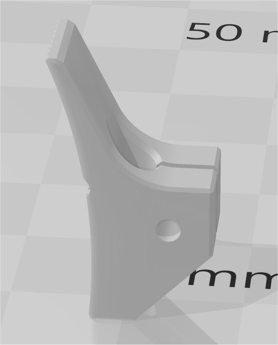

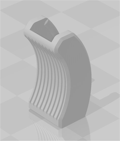

One option might be to 3D print a shoe for it. My wife has very small hands, and needed a shorter trigger for her new MatchGun MG2, so I printed one up:
Short MG2 Trigger Shoe.jpg (19.94 KiB) Viewed 4204 times
Later, I was going to use an AR-7 .22 rifle to introduce some beginners to shooting, and the trigger is narrow, stiff & very uncomfortable, so I made a snap on shoe for that:
AR-7 Trigger Shoe.jpg (18.55 KiB) Viewed 4204 times
You need a fairly fine resolution printer (mine is 0.2 mm layers, with a 0.35 mm pozzle) to do these sorts of small detailed parts effectively.
