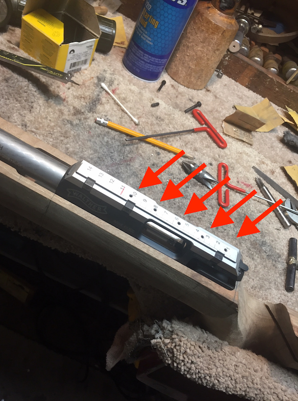

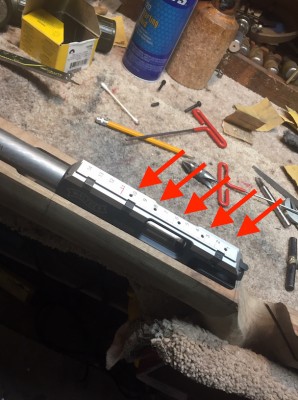

Could someone please let me know what the holes located at the top of the action are for?

The holes that you indicate are in the full length riser, not the action itself. They are threaded for the spacers that are used with the Centra Block Club risers https://shop.mec-shot.com/sights/sight- ... -club.html

That photo has an additional raiser block on-top which still doesn't demonstrate what the holes are for.
Posts: 2096
Re: Walther KK500 Action Query
GolfShot wrote: Mon Jan 11, 2021 12:11 am That photo has an additional raiser block on-top which still doesn't demonstrate what the holes are for.
What he means is that the holes in the full length riser turn it into the bottom half of a Centra Block Club. See here:https://www.intershoot.co.uk/acatalog/C ... s-255.html
Screw the little spacers into the holes then screw the top dovetail from a Block club in top. You could have finer adjustment than just sliding another riser onto the full length one.
