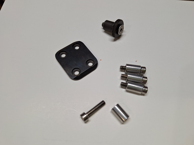

I actually made four tiny aluminum pillars for the four small bolts; and used a drop of blue Loctite on all five bolts. I'm at about a case and a half, and my torque driver still clicks at 3.5 Nm. I imagine the bolts would loosen a little bit directly through the wood with no Loctite. 3.5 is what Walther (Germany) told me in email. 3.8 is certainly not going to be too much, and is probably correct for composite/aluminum stocks. I've never seen it specified in print anywhere.

could you post a photo of the pillars. curious to see what they look like how there installed.analretentive wrote: ↑Mon Aug 19, 2024 9:57 pm I actually made four tiny aluminum pillars for the four small bolts; and used a drop of blue Loctite on all five bolts. I'm at about a case and a half, and my torque driver still clicks at 3.5 Nm. I imagine the bolts would loosen a little bit directly through the wood with no Loctite. 3.5 is what Walther (Germany) told me in email. 3.8 is certainly not going to be too much, and is probably correct for composite/aluminum stocks. I've never seen it specified in print anywhere.

Golfshot,
Forgive me for not disassembling my stock, but I did buy an extra set of hardware. It's just basically four aluminum spacers ,(aluminumspacers.com....11/64 id, 5/16 od). You have to rebore the four holes in the stock. (Don't do this if you don't have access to a mill), cut the spacers close to length. Epoxy in place flush on the inside, then file, mill, sand flush on the outside. Probably way overkilled, but I'm anal.
Don't use Loctite if you don't use pillars. This information is for the Walther wooden benchrest stock.

Thanks for that photo. Is that enough thread engagement? Doesnt seem like much.analretentive wrote: ↑Sat Aug 24, 2024 10:17 am Golfshot,

No. The spacers in the photo (1/2") have not been cut to size...will lose about 1/3 of thier length.
