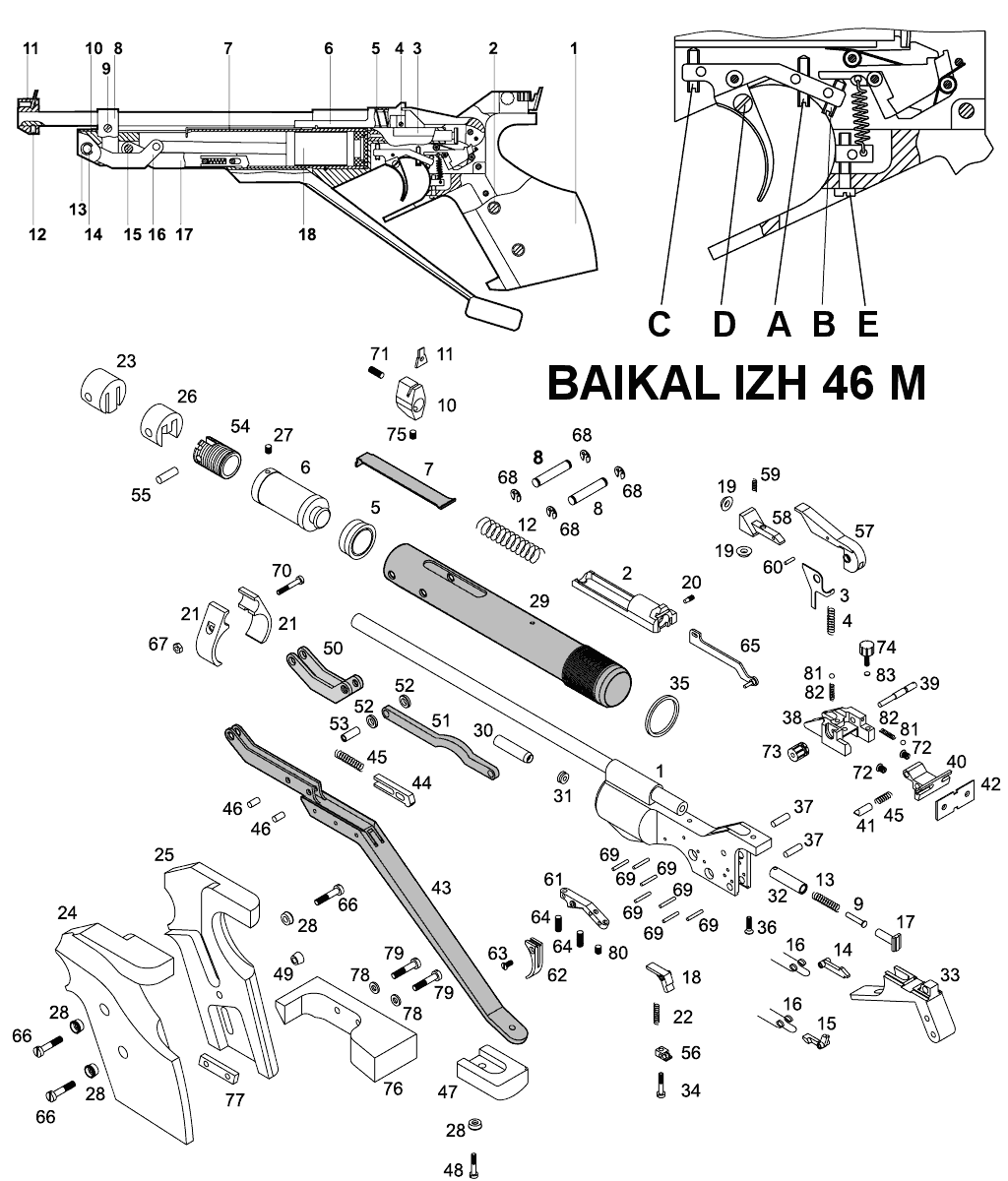

Does anybody know, what part/parts are responsible for keeping the breech block up after cocking?
Mine just does not want to stay up, requires raising after cocking. Started from not staying sometimes, gradually went to always dropping.
TYIA
Posts: 645
Location: Ohio
Re: Izh 46(M) breech block
Look at spring #4 in the attached diagram (directly below the words IZH 46M). It may have just come unhooked. (That has happened to us, in the past.) There are also some instructions for disassembly on Pilk's website.
http://www.pilkguns.com/izh46ex-htm/

Thanks. #4 is in place, not worn off and well hooked, problem is probably with something else :(
Posts: 3561
It's been a while since I was inside one, but I think it stays up by virtue of the shape of the lower surfaces of the block where meets up with the valve stem (#17). It has a camming action, and if the surfaces of the lower corner of the block get worn, it may not want to stay up.

Yep, #17 was my suspect, as it has signs of wear.
As the breech is able to stay up when the gun is pumped, I tried to extend valve spring, but it did not change anything.
I do not have problems with manually raising breech after cocking, but once in a while on the way up (pressing on the valve?) it causes some air loss, which is obviously not fine.

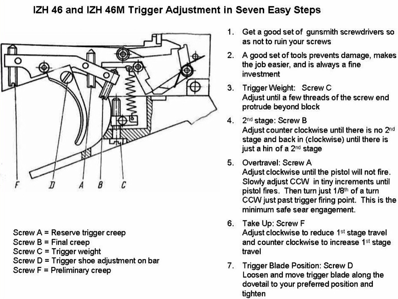

Interesting video of the IZH-46M triggering action. Perhaps it will help others, in the future.
Triggering-
https://www.youtube.com/watch?v=cfgFG76DBGE
Full action-
https://www.youtube.com/watch?v=LoVekydiBRk
Trigger adjustment instructions...

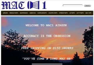

PeeWeeDaddy wrote: Sat Apr 08, 2023 8:53 am IMG_1725.jpegSend it to Tim McMurray.
He will repair your 46m to better than new.
He has a valve he can install that will NEVER wear out.
If you don’t want to send him the gun check with Air Venturi about repair parts and repairs.
mac1airgunshop.com
WARNING! I sent my 46M to Mac1 and he had it for over a year and never did a thing to it. Multiple phone calls, BS excuses from him and angry words. Do not send anything to this guy. He will tell you he had a serious accident.... but he had my gun for 6 or 7 months before that happened. The only credit I can give him is that after a loud and angry phone call (not my general demeanor) he did after 14 months, mail back to me my untouched pistol.
I had sent this AP to him some 11 or 12 years ago to be "Mac tuned" and service was fine including fast turnover, so I didn't hesitate to use his services again. Huge mistake.
