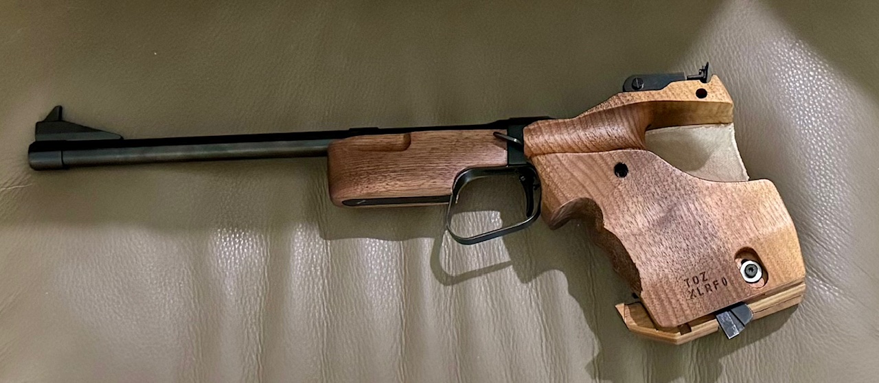

Is there anything particular problematic or wrong with removing the fore end of a TOZ 35M with just an aluminum or wooden spacer and shooting it with everything just hanging out in the breeze? I have been using an aluminum TOZ Balance but I took it off any this seems a bit of a revelation. I do have a nice Rink wooden fore end that I could saw off short as well. It seems like every gram I can save out at the end of my arm is a good thing.

Short answer: no. It's just a big wooden spacer.

Well I chopped off the Rink fore end and shaped it a bit. I weighed it on my good scale that makes me look like an extra from Breaking Bad and it comes out as 28 grams. So right at about an ounce. It does cover some stuff up and I think I could make it a bit lighter. (The scale is really for weighing violin and viola bows in real life I’m a musician and instrument collector) I saw a fellow shooting a TOZ in a World Cup final with a bobbed off fore end so I just kind of copied that. (Old video)

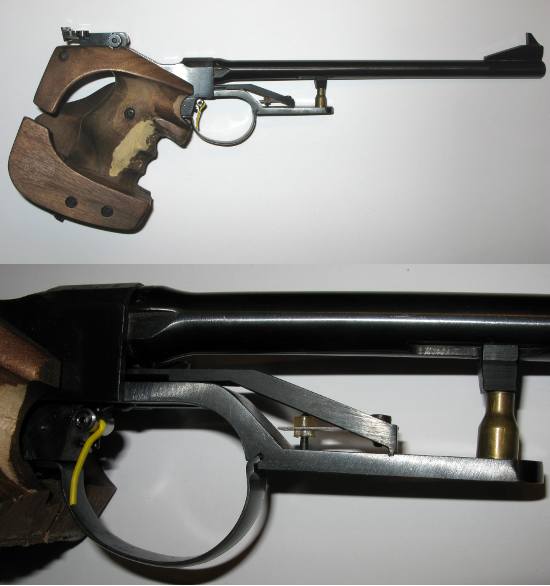

I threw away the butt ugly wood fore-arm, sawed off a piece of .223 brass and used that instead.
UGLY? Yes, but I think anyone shooting a TOZ doesn't give a damn about esthetics anyway.

Shooterer wrote: Mon May 20, 2024 10:42 amtunetoz.jpg
Perzackly!!!
I also made springs out of small paper clips that work better than the originals.

I think this worked.
DLB
Light weight (approximately 24 gram fore end)
