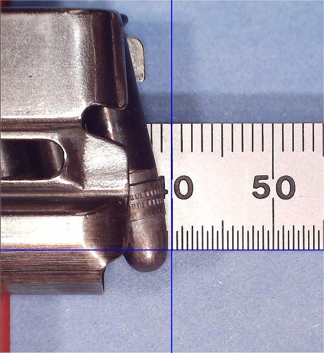

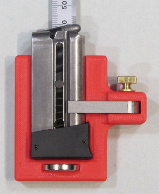

Step 1 was figuring out how to measure the bullet heights. I wanted to reference the height to the top of the magazine catch slot, and then use my digital microscope to measure the bullet height. Ideally, I wanted to measure the height of the tip at the centerline of the bullet, but I couldn't figure out an easy way to do that, so I just used the top of the bullet nose. I used dummy rounds for the testing, and I used the same rounds, loaded in the same order, for all of the tests. I 3D printed a fixture, and machined a steel lever that would fit into the magazine catch slot.
The end of the scale is at the same height as the top of the magazine slot, and I located the fixture at the 40 mm mark in the microscope for consistency:

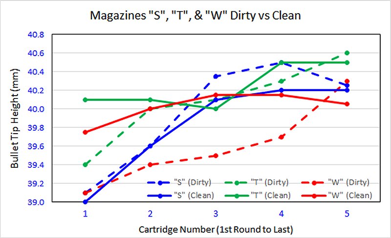

I went through all of the various magazines. The fixture only works for 6-round magazines, but that covers the majority of the ones we have. I figure the lessons learned would also apply to the 5-round versions. I may redesign the fixture to work with both if I think it's important. I measured a bunch of dirty magazines, and then re-measured them after cleaning. Ideally, you would want the bullet height to be consistent from the 1st round fired to the last. There is always some variation, but cleaning reduced that in all of the magazines I tested. Some of the magazines were really grubby, and showed the biggest improvement.
After cleaning, the average height was 39.8 mm, and the average peak-to-peak variation was 0.8 mm. What I discovered is that most of the pistols with sharp chamber edges had managed to get paired with magazines that had a LOT of variation in bullet height (as much as 1.6 mm). My hope is that the average height isn’t too critical, and that pairing low variation magazines with the sharp chamber edge pistols (which I’m still working on) will minimize the problems.

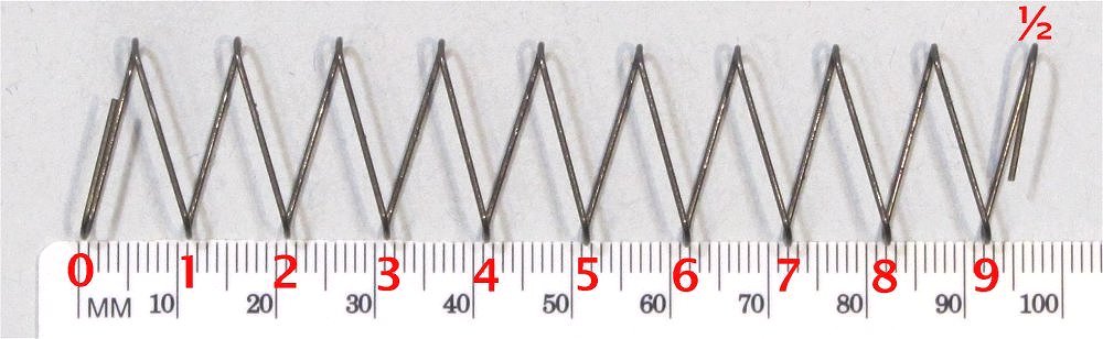

I collected data on a lot of the various springs I encountered. There a huge range of lengths, number of turns and wire size. Most of them are 9 1/2 turns:
That means the ends are parallel. I also found quite a few where they had an even number of turns, so the ends are not parallel. I have several relatively new magazines that have never been cleaned, and the springs were all oriented with the top end loop forward.
Most of them averaged about 107 mm in length, but I found some as short as 85 mm. What's weird is that I found long springs in a few 5-round magazines, and short springs in some 6-round magazines. I cleaned all of the Team magazines about 4 or five years ago, always one-at-a-time so I wouldn't mix up any of the parts. Many of the magazines showed no sign that they had ever been disassembled in the past, so I'm guessing the various springs came that way from the factory.

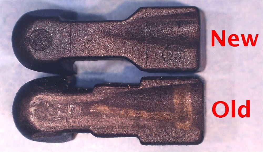

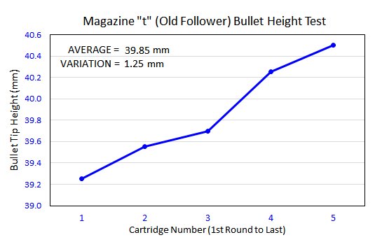

The one thing that more upward force near the back will do is wear out your followers faster. The follower wants to hold the back of the rounds offset to the right, but the top of the magazines wants to hold them centered. When the last round is being fed, those two argue, and the left side of the offset groove in the follower will lose. I've replaced quite a few followers. Here's a comparison of a new one and a very worn one:

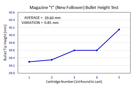

When they get that worn, the back end of the last round is lower, so the bullet ends up higher. I took data on a magazine before and after I replaced the follower with a new one:
5-16-24 Mag 't' Old Follower.jpg (30.28 KiB) Viewed 5561 times
5-16-24 Mag 't' New Follower.jpg (29.72 KiB) Viewed 5561 times
As you can see, the worn follower affects the height of the last 2 rounds quite a bit. The second to last is actually affected more than the last one.

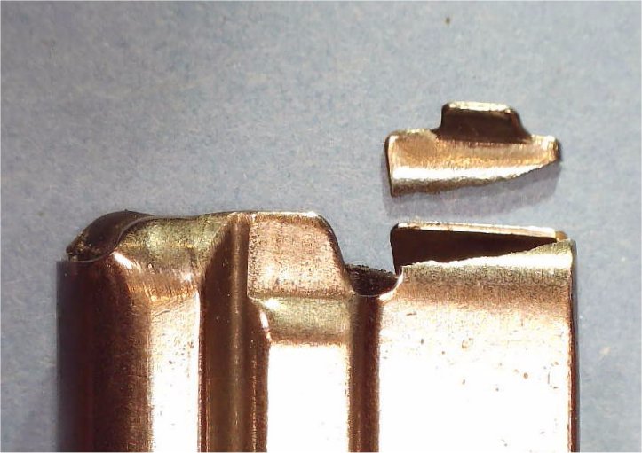

One thing I discovered the hard way is that you should NOT attempt to adjust the shape of the metal magazine lips. I have been thinking about trying that, but was concerned that the metal might be brittle from work hardening during the forming process.
I accidentally knocked one of mine off my work bench. Of course, it landed on the ejector tab. I figured it might be bent a bit, but when I retrieved the magazine the tab and a good chunk of the top side was broken off:
If you decide you absolutely MUST bend them, you'll want to try to anneal them a bit first.

The bullet height fixture is a lot more complicated. You need to machine a metal bar that fits into the magazine catch slot, or you won't have a consistent reference point for the height measurements. That fixture does have the button accessible for the reason you stated. I would tip the magazine with the bullets up after removing each round and relax the tension on the follower. That way all the remaining rounds were seated at the back of the magazine. I think I started out by mirroring the disassembly bench block design.
The shiny silver object in the bullet height test fixture is a rare earth magnet. It holds the magazine body down against the locking arm, and also helps secure the fixture on the steel base of my microscope so it doesn't slip around too easily.
