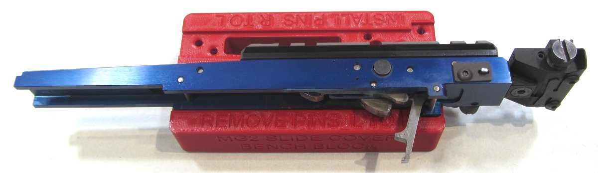

I have my 3D printed MG2 slide cover bench block up on Thingiverse now: https://www.thingiverse.com/thing:6662216
The Summary includes notes on how to use it. It's labeled so you drive the pins in the right direction, and it will accommodate pistols that have one of Jon Eulette's optics rails installed.

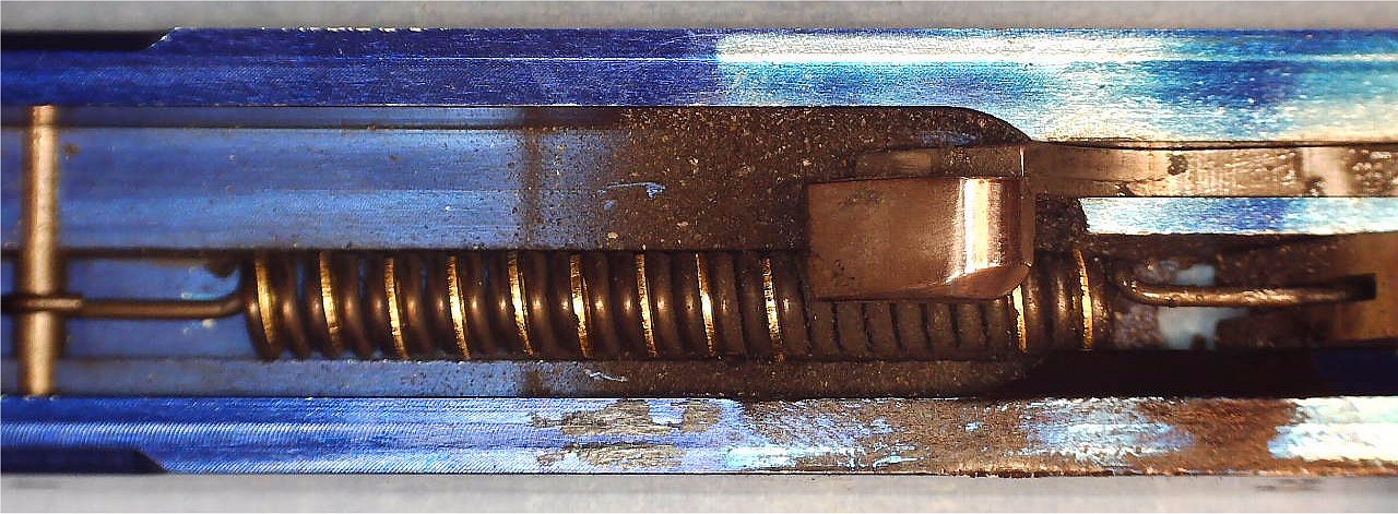

The trick that really helps if the hammer spring is intact (like when replacing the BIL) or when you need to install a new one is to stretch the spring by inserting a bunch of small washers between the coils.
The washers I use are General Purpose Brass Washer for M2.5 Screw Size, 2.700 mm ID, 5 mm OD, 0.40 to 0.60 mm thick

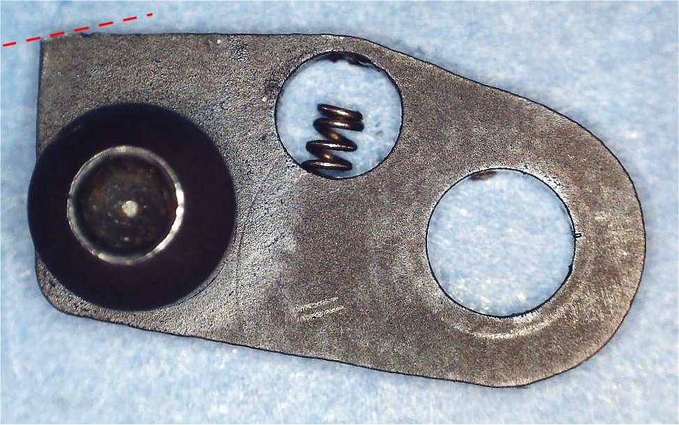

Here's a picture:
I don't know why they would recommend against removing the carrier. If you do it a lot and don't take care to examine the set screw & replace it if it gets chewed up, you could eventually wreck the threads in the frame, which would be very bad. It's not a job for a lot of hamfisted gun owners, but if you are careful, I don't see the harm. The MG2 collects fouling faster than any pistol I've ever shot. Eventually, the fouling will build up to the point where it will cause malfunctions. You can flush it out with an aerosol gun cleaner, but then you have the problem of relubricating everything without getting oil everywhere.

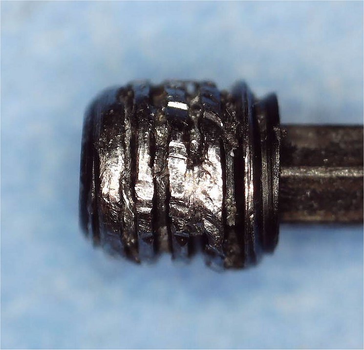

The problem with the set screw is that the pivot pin for the carrier is free to rotate a bit. The groove that is ground into the left end is not a tight fit, so as the carrier operates, the pin rotates back & forth. The pin is hardened, and the factory makes no attempt to break the sharp edges on the pin. As a result, those edges dig into the screw threads and damage them.
Here's a photo of the screw that came out of my first MG2 when I removed the carrier for the first time:

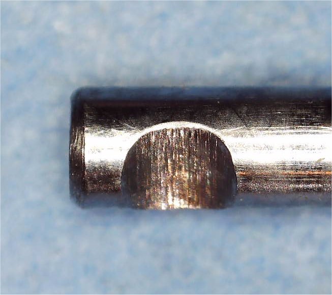

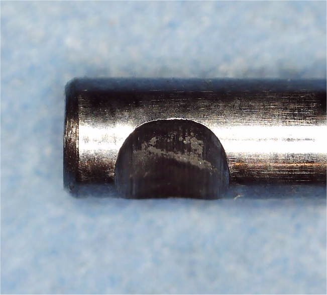

What I have done since then is to stone down the sharp edges on the notch in the pin to reduce the damage. Here are before & after pictures of the pin:
When I've removed the carrier since then, the damage is minimal, but I still occasionally replace the set screw if it feels the least bit rough coming out. From an industrial supplier, a bag of 100 is $10 USD, so it's cheap insurance.
