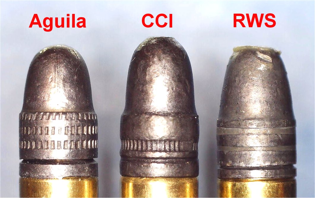

Feeding problems are often affected by the magazines. Label them, and see if there is any difference in how often you get mis-feeds with each one.
Does the mis-feed mostly occur with a particular round? First round jams may have difference causes from 5th round jams.
You can also feed a round, but don't fire it. Carefully remove it and see if there is damage to the bullet. You can mark the top of the case with a marker, and that can help you see if the rounds are feeding too high, or too low.
Different ammo has different bullet shapes. Pistols that have feeding problems may work better with rounds that don't have a large/sharp shoulder on the bullet. Here's a comparison of Aguila, CCI, and RWS:
RWS tends to feed better in fussy pistols than the other two. Norma TAC-22 is loaded by RWS (the cases have an RWS headstamp), and is an economical alternative to a lot of the more expensive European ammo.
