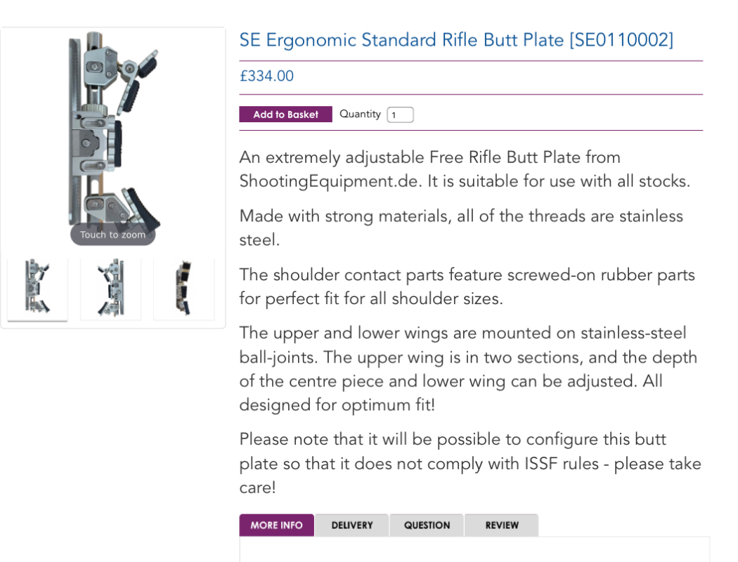

I currently use an old Anschutz 1813 Match 54 and it uses one the original butt plates which only allows up / down adjustment on a sliding plate. It is not hook style butt plate.
I have been shooting prone for less than 12months on 25/50 range and noticed the butt plate has limited contact with mu shoulder due to an old collar bone injury where it didn’t set correctly so I have a slight lump / collar bone protrudes very slightly.
My thought process was to buy a highly adjustable butt plate that you find on many aluminium stocks and attach that to allow a better configuration / better contact with my shoulder.
My question is: Are these modern adjustable butt plates compatible with the Anschutz 1813, do you need any kind of adapter or do I have to invest in upgrading the stock to Aluminium? See attached as an example.
Any advice welcome.

Yes, most modern buttplates are compatible with an 1813. I'm guessing from your description that you have an early-ish one*. Your 1813's butt is made up of three parts: 1) the plate that moves up-down and touches your shoulder ; 2) the base it moves on (should be silver-coloured on an 1813) and curved. 3) the carrier, a black metal plate with three prongs that gives length adjustment.
If you remove the plate you'll see the base is held onto the carrier with two hex-head bolts. Undo these, remove the base, and you can bolt the new buttplate onto the carrier; there will be holes/a slot for the bolts. On the carrier the bolts pass through horizontal slots so you can move the plate sideways/can to fit your shoulder and achieve the desired cant (or lack of cant) on the rifle.
Alternatively something like the System Gemini comes with mounting rods; just wind out the carrier all the way, slide in the SG rods and away you go. It will hold correctly still without the threaded centre rod.
*Assuming you have an 1813. I've met more than a few shooters who thought any thumbhole-stocked Anschutz was an 1813. That's not the case, an 1813 is a specific model made from 1980-'87: thumbhole stock + straight fore-end. Confusingly Anshutz marked the 1810 (cheaper 1813), and 1811 (prone-only stock) as 1813. An older rifle, or an 1811 would also match your description, but would require a different approach to an actual 1813.
