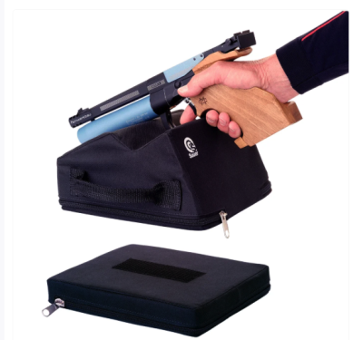

I mean the one for standard air pistol competition - to be put on a shooting bench. Like in the photo:

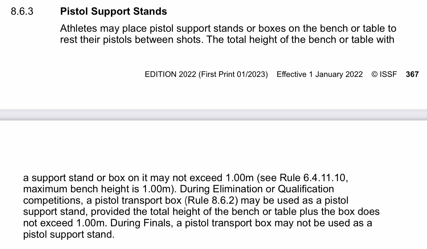

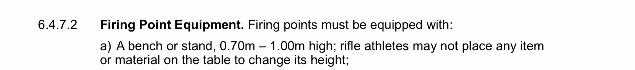

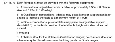

The minimum height of the firing point is .70 meter, the maximum height is 1.00 meter. Parts of the rule are scattered in different places,…
Section 6-
Also, Section 6
Section 8-
When the Sauer blocks are being used by an athlete I have seen range officials measuring to make sure that the height, at the top of the block, is not more than 1.00 meter. Should not be an issue with height adjustable firing point benches.

As long as it isn't higher than one meter, to comply with rule 8.6.3, you can use it.
