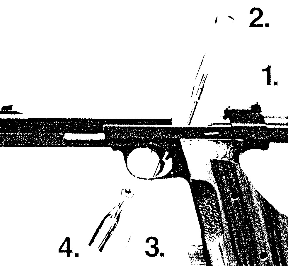

The origional 208 has minimal trigger adjustment.
Also has two trigger setups depending on serial number.
Trigger weight, slack and travel.
There is no sear adjustment.
